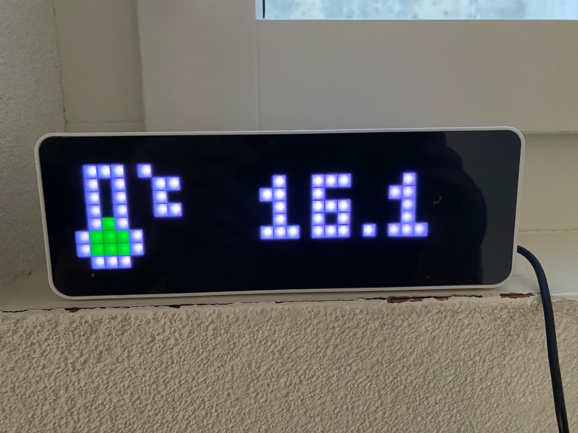

if it’s just a simple value like the temperature or similar, you could also use Matrix Display like LaMetric Time or the Ulanzi TC001. I’m using both to show the Outside Temperatur obtained via MQTT. La Metric is quite expensive an limited to one DIY App. the Ulanzi TC001 is far cheaper but you better flash it first with AWTRIX Light https://blueforcer.github.io/awtrix-light/#/ , which will allow you to deploy custom apps. to get simple values on the display, you need modify the payload to device specific json and publish it to the MQTT topic you configured as custom app. I do this with Node-RED in between, which subscribes to the values published via Openhab Rule to my MQTT Server, converts the Payload in expected JSON and publishes it back to the new Topic configured on the device.
Sorry for hijacking/advertisement in this thread but I also created a binding for the ulanzi clock: Awtrix 3 Binding (formerly Awtrix Light)
Maybe you want to give it a try :grimacing:
It would be great to have some more users testing this :blush:
