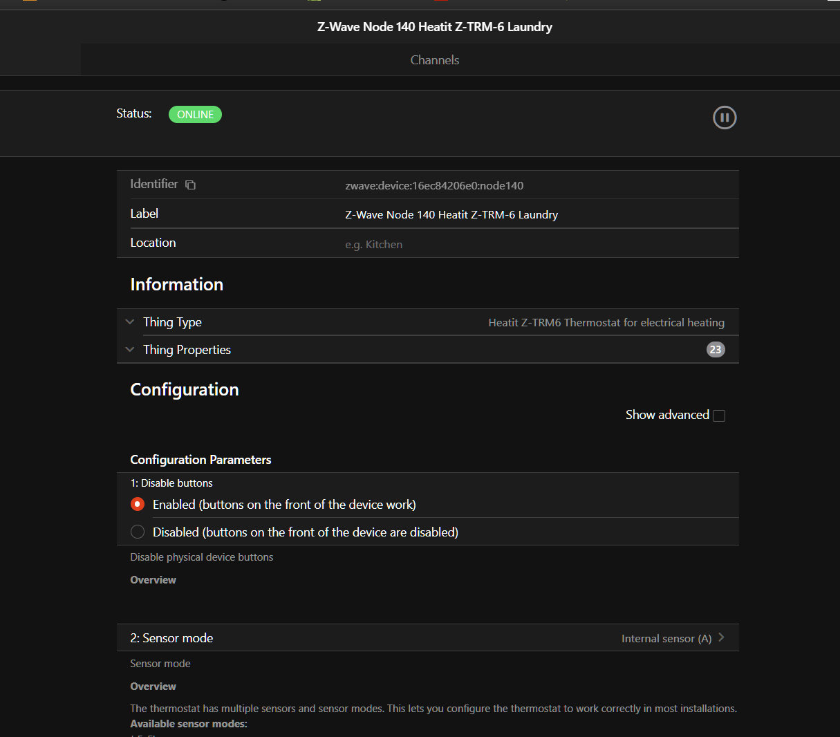

Yes I did and it works fine. I had to register the device in the opensmarthouse.org Z-Wave database (with the help of the support of the manufacturer). Since my review request for this entry is not answered yet, I assume that the device is currently not included in the OH Z-Wave binding. So you have to manually include it there by following the guide here, like I did.

Installed Z-TRM6 just now, and it shows up with no channels.
But, I think I just wait for it to tag along in a later OH4M release. Happy with local control for now.
You can refer me as a +1 waiting for it to be included.
I also waited for a review once, after correcting and adding to the documentation, but never heard back.
Let’s hope someone picks up on your review …
I just saw that my entry was approved on 11/19. So the configuration should hopefully be included in the next release of the binding.
So it should be part of the just released openHAB 4.1 Milestone :wink:
Yes, it was: 4.1.0.M4 :slight_smile: Kudos!

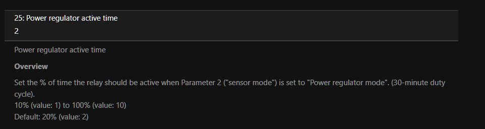

With the introduction of the Z-TRM6, the power regulator mode, from the discontinued Z-TRM2, was re-introduced. (Z-TRM3 does not have a P mode). The database does not provide a channel for controlling this though:
Here are the channels available for the old Z-TRM2:
I can recall that back in the days, Chris helped me adding the then parameter 12 as a P setting channel.
On the Z-TRM6 this is now parameter 25:
I even think he did the Display Brightness and Eco Setpoint channels as well.
Could the Binary Switch set be made Switch channels as well?
