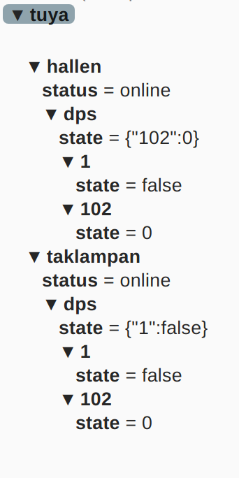

Finally some steps forward. I got some info on mqtt explorer
I installed a new version of ubunutu, mqtt-tuya and mosquitto.
mqtt explorer info

Why can’t I see “sovrumslampa” and “sovrumstv” in mqtt explorer?
mqtt explorer:
I have tried topic (for “sovrumsplampan”):
tuya/0226785468c63axxxxx/ccff77103cxxxxx but no connection

When I use openhab, mqtt explorer shows command = OFF or ON (but no action)
when I use smartlife app, mqtt explorer chance state = true/false and the lights turn off/on
