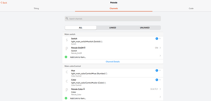

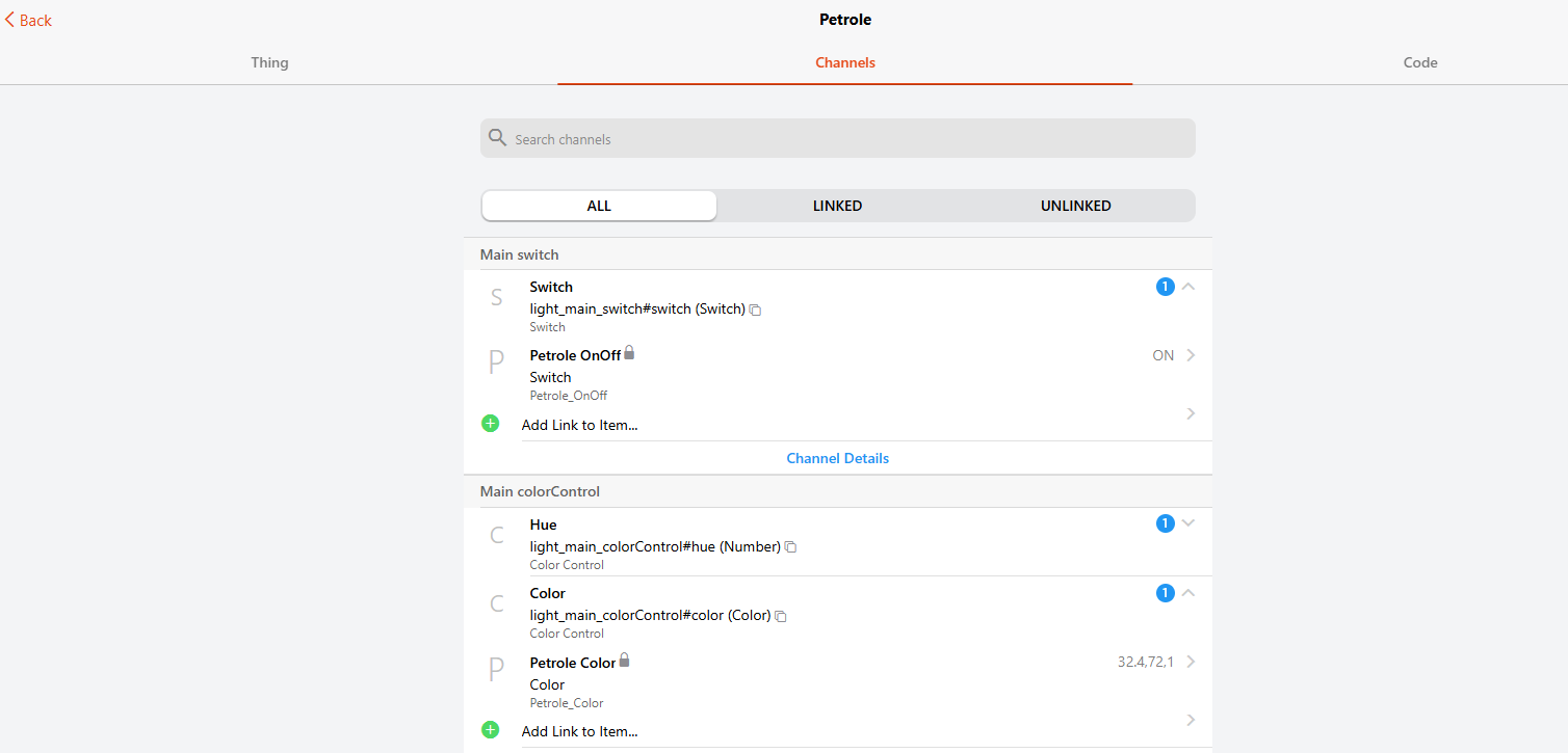

About the channel update, can you please precise:
No channel update at all on any of your things ?
A mix of some chanel update, and some other not update on a specific thing ?
Is this specific to your dryer thing ?
Also, don’t expect the new binding to be compatible with your old .items definition file.
For test purpose, can you just create new items directly from UI, and see if it works.
I don’t check in details, but not sure that your current items map correctly to the things channels.
The first is to check in your thing definitions if channels are correctly link to items
