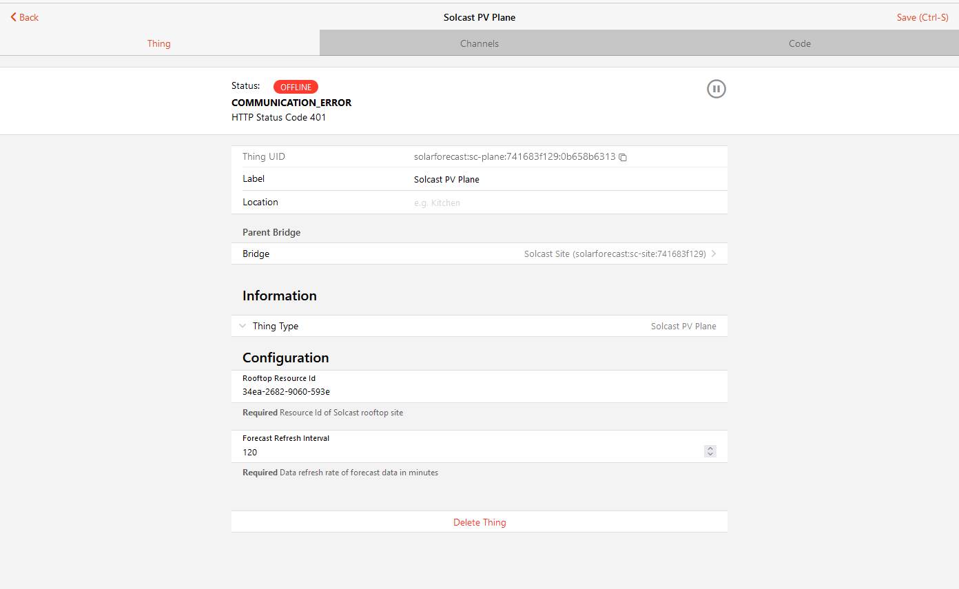

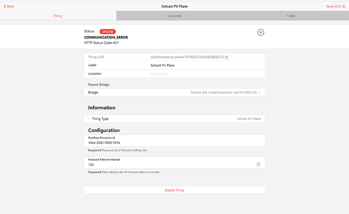

I’m new to this binding and now trying to setup it under OH4.2M2. I have setup both the Solcast and ForecastSolar accounts. I’m having difficulties with Solcast PV Plane Item (see attached screen copy).
I have checked that the Rooftop Resource ID is correct. Any ideas?
Hey jlikonen!
Because of the 401 error it seems there is something wrong with the authentication.
Bye HFM
Yes, I know there is somthing wrong. I also tried to put
[type or paste code here](https://api.solcast.com.au/rooftop_sites/34ea-2682-9060-593e/forecasts?format=json)
for the Rooftop Resource ID but the Solcast PV Plane Item still shows OFFLINE. Solarcast Site Item shows ONLINE but Solarcast channels show NULL so there is something wrong.
Remove SolarForecast Binding delivered by Milestone build.
Then drop 4.2-SNAPSHOT from top post into addons folder. This will work!
OK, thanks. Now it works. Another error was that I had accidentally used Rooftop Resource ID for the API key in the Solcast Site Item.

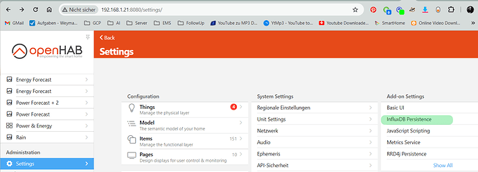

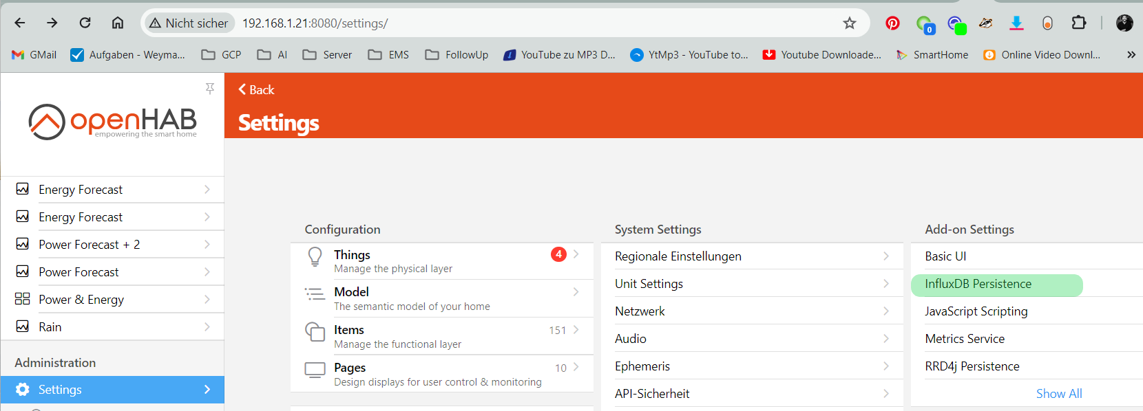

I’m curious why you transfer the forecast data via DSL rule. There’s no need to parse the json and transfer it inside the rule towards influxdb.
Let’s break it down and please check each step:
  • you have an influxdb server running somewhere, local or remote
  • you have installled influxDB Persistence service installed in OH and configured it correctly (Pic 1)
  • you have influxdb.persist file in folder persistence like described in readme
  • you marked your items which shall be stored in influxdb with influxdb group like described in readme
This is my testing environment and without any rule the data is stored correctly (Pic 2)
