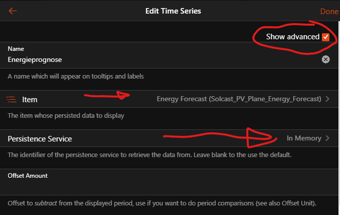

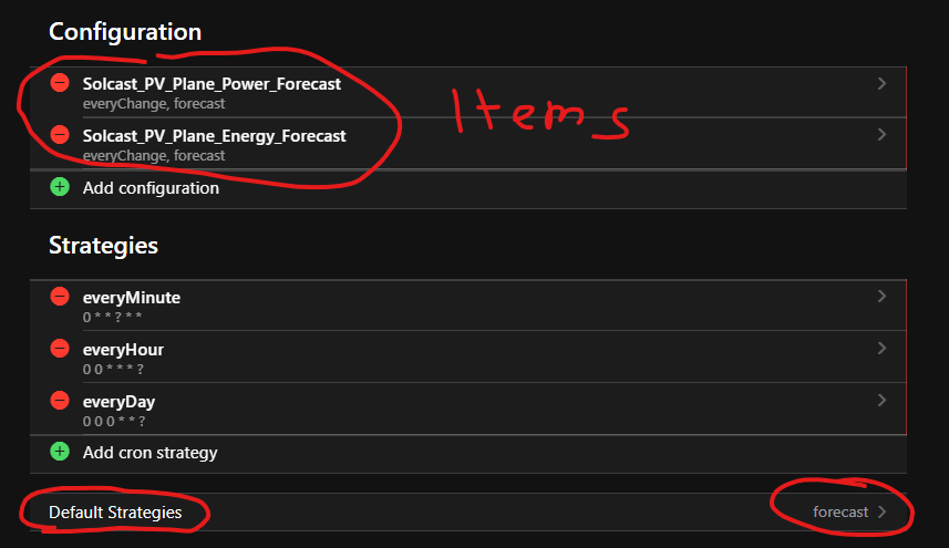

FYI if you already have InfluxDB then it’s fine. I’m using now “In Memory” persistence. This is easy to setup and no need for additional/external tools:
“In Memory” does not support “Restore at Startup”. But to show future values this is not needed in my opinion. I’m happy with it :slight_smile:
Configuration “In Memory”:
Then create a chart in MainUI and make this setting:

Only way I could make the future values visible (with rrd4j as default persistence) was to create a new chart (pages), add a new grid and configure according above screenshot I have posted.

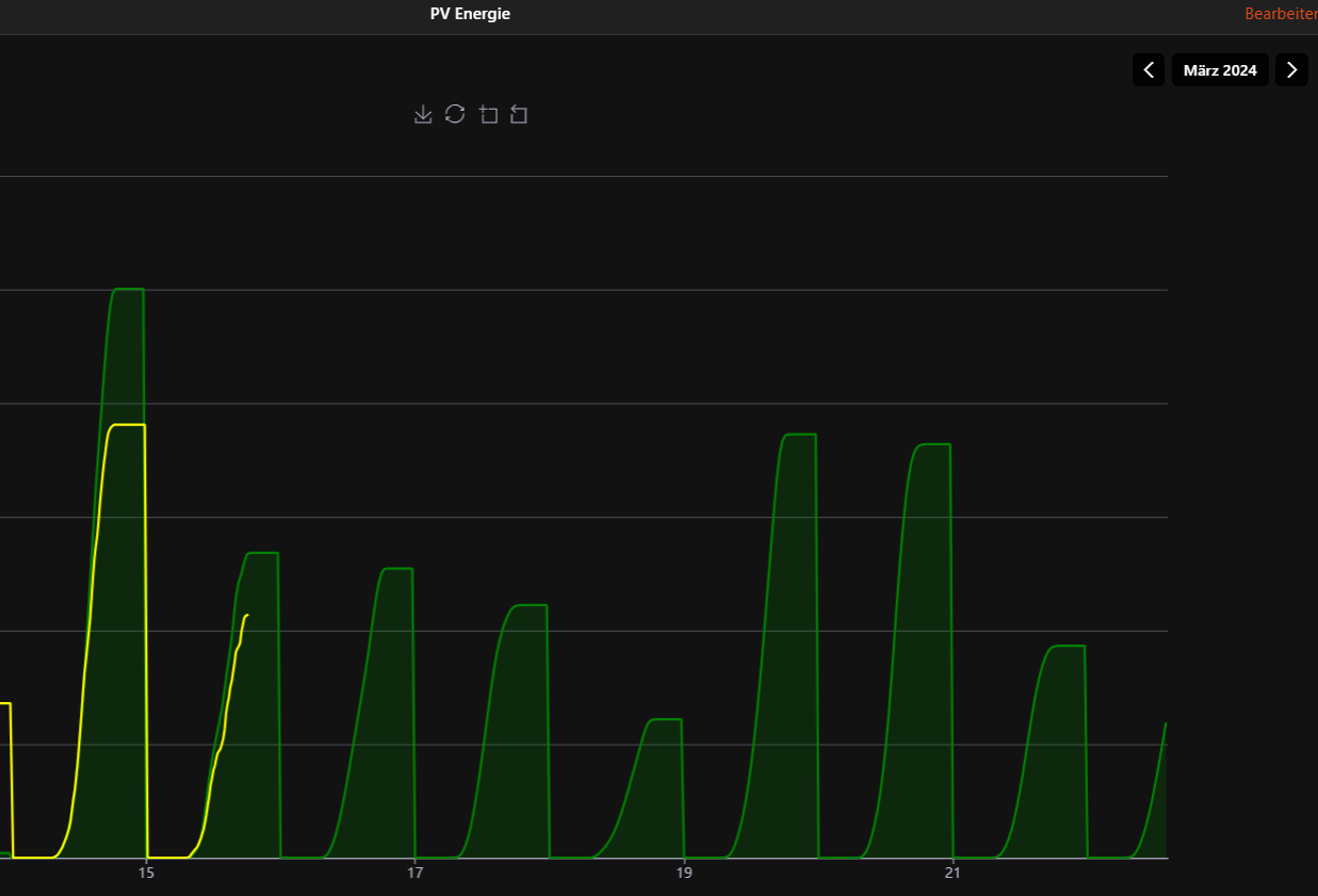

As mentioned in previous posts I have succesfully implemented time series with future data using “In Memeory” persistence.
In below screenshot we can see:
Green = Forecast Energy
Yellow = Actual Energy (from Inverter, not Binding)

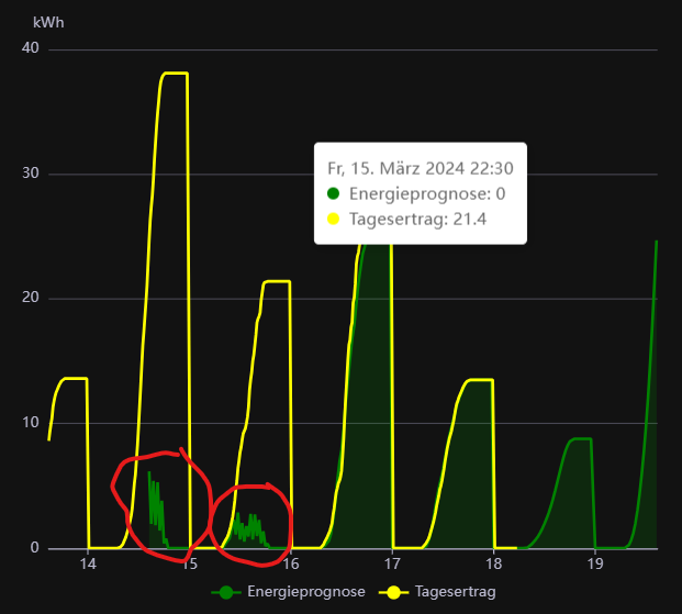

I’m not sure if people who use InfluxDB see the same thing, but there are strange values in the past. The day before and 2 days before are OK (in above screenshot March 16 & 17), but older dates are weird.
Is this what we are getting from Solcast (yes, I use Solcast and have not tested Forecast Solar) or is it a bug in the binding? Is there a way to not updating past values?
Using Forecast.Solar subservice and persisting in InfluxDBv1, I don’t see such effect.
Yet, on any new timeseries transmission, openhab log warns that InfluxDBv1 doesn’t support data removal: [rnal.influx1.InfluxDB1RepositoryImpl] - Removing data is not supported in InfluxDB v1. This appears both for SolarForecast and OpenWeatherMap timeseries transmissions. With this I suspect that timeseries in openHAB tries to “sync” persistence service with transmitted data? InMemory persistence specifically allows deletion (maxEntries). Your graph might show leftovers? What if you double or cut the maxEntries setting?
