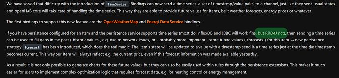

The update towards TimeSeries takes much more efforts than I thought! It’s not working out of the box. See picture below of the OH 4.1 Release Notes. You need e.g. an influxdb to store future values - standard RRD4J will not do it. Due to this fact a graph for future values isn’t provided also

@J-N-K is it correctly interpreted that persisting future values won’t work when you run rrd4j ?
I’m struggling to infer that from the description in the Release Notes.
Given that’s our default OH database it’s the most important that all bindings to make use of TimeSeries should work with, shouldn’t they.
Do the openweathermap and Energi DS bindings work with rrd4j ?
Correct. RRD4J can’t be used with timeseries because the databsse is not modifiable. In fact, for most cases where future values are useful (like prices / forecasts) the aggregation done by rrd databases would be a bad idea anyway.
InMemoryPersistence would also be easy to use and it supports timeseries.
