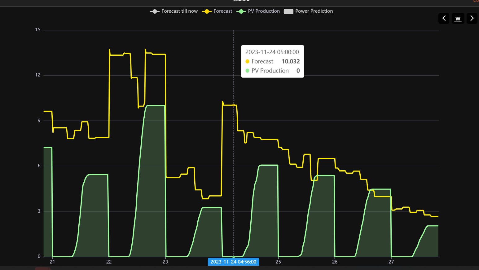

It’s a pity. I my case resp. location I do see an enormous fluctuation in the daily forecast (blue line in the chart below), and some kind of smoothing would be very useful.
Yes, I know. I’ve a similar graph showing fluctuation
But I would refuse to do any smoothening because I simply forward the data received by the provider.
What shall smoothening look like?
If I receive a 50% increase / decrease from the provider shall I say Ahh no, that’s too much - let’s take whatever-not-too-much% and calculate the forecast on my own?
Sorry for any misunderstanding. I wasn’t asking you to do smoothing. I just think it is a pity that the provider has killed the capability to incorporate user system feedback into its own forcasts. (It would probably be a good candidate to do with an AI algorithm)..

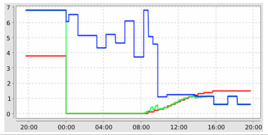

Typically the Forecast.Solar forecast is absurdly optimistic during the night time window – see example from today below where its forecast (blue line) during the night time low tariff window was ~5kWh whereas the actual (red line) and ‘to go’ (green line) results ~1kWh.
This over optimism resulted in me charging the battery by ~4kWh less than I should have done, and therefore having to pay for that energy at the day tariff rather than at the 30% lower night tariff.
I wonder if this is a specific problem with Forecast.Solar? And/or if Solcast is better?
Any thoughts?

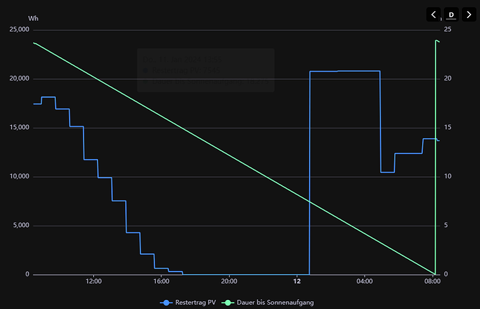

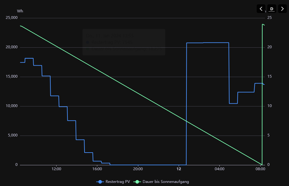

What data point are you using? I’m thinking you’re using the “overal forecast” for the day? That sums up the forecast for the whole day (midnight to midnight), and therefore has of course also the dark hours “within” so to speak.
What i do is to calculate the “hours until sunrise”, so my rules can see, when to expect solar energy:
As you can see, after midnight the forecast is calculated for the present day and then gets updated as we move forward. It can be, that there’s a sudden peak or decline - depending on weather forecasts (overshadowing, rain/snow, …), that’s why there’s no “20kWh forecast declines linearly until midnight”.
but I can see, why your misconception is there in the first place, the declining ends exaclty with sunset - but don’t start with sunrise.
Yes that is correct. At 00:15 I look at the forecast for the newly started day. And if it is forecasting a lot of solar energy to be produced during that day, it will not charge the battery during the period 00:15 .. 07:00 .. Whereas if it is forecasting very little energy during the day, then it will preload the battery before the sun rises (and the tariff rises)..

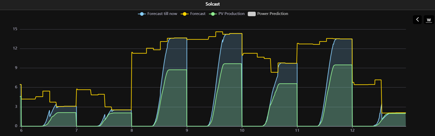

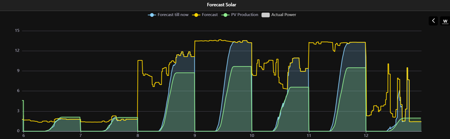

Due to the fact Solcast has very strict API throttling it “looks” more stable. But you can see also too optimistic data including up/down peaks during the night. Jan 6th and 7th (first 2) forecast.solar was pretty stable and more accurate than Solcast. See pictures below.
I wouldn’t do so. As far as I can see from the docs on the bottom forecast.solar is using DarkSky API as weather forecast. Don’t think another weather forecast on top makes sense.

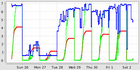

I can see in your graph this drastic discrepancy. Is this systematic behavior on your side?
Solcast last week
Forecast Solar last week
Pretty much. Yes.
