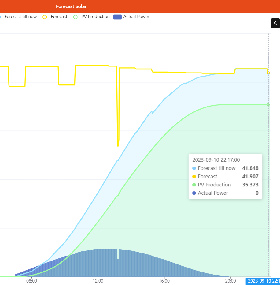

I must say that I use the echarts of OH more than Grafana nowdays, because it’s better integrated and lots of possibilities. Although creating graphs with Grafana is still much easier.

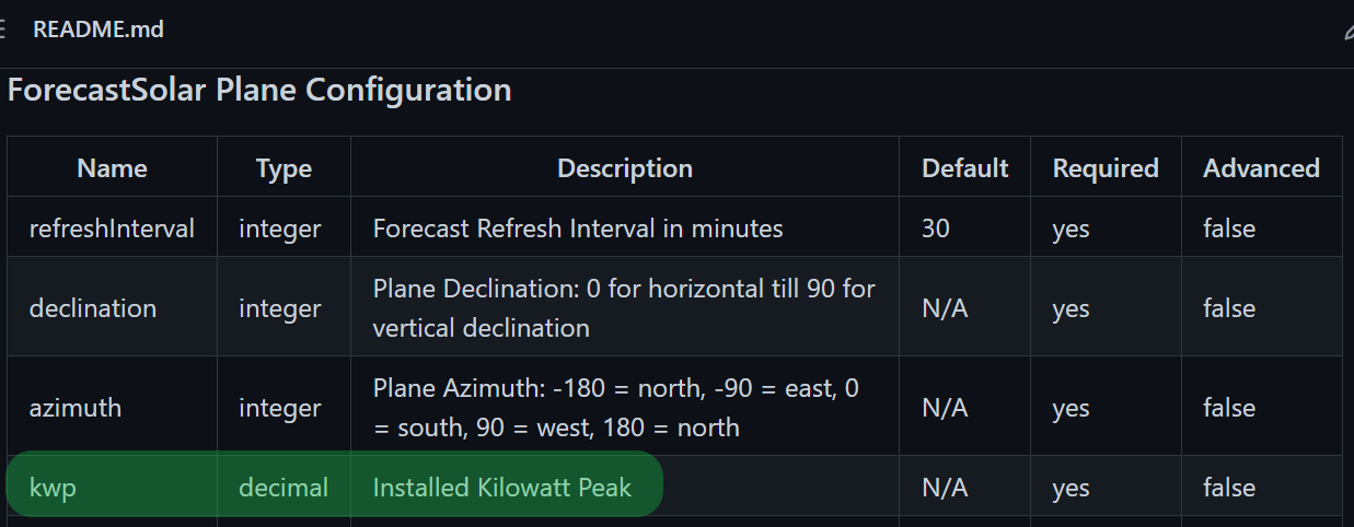

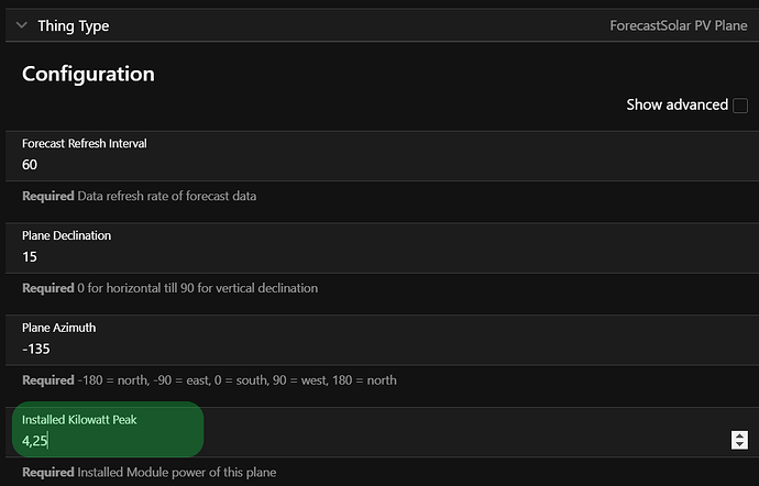

I don’t know if this has been mentioned here, but for ForecastSolar you only allow full values, no floating values. Since I only have a small 0,8 kWp solar module i checked their api. It is actually possible to use float values. I just changed the value from 1 to 0.8 in the Openhab code section and it still works.

Don’t know where this information is coming from. Double checked in readme and code - both floating values. I’ve 2 planes, both with floating values working since the beginning.
My Config

True - fixed it.

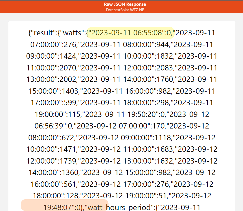

I’m plotting the current ForecastSolarSite_ActualPowerForecast item while overlaying it with my actual data from the solar power plant. There is an offset of 1h, the forecast runs 1h early. Is there any way to correct that in the binding or setting? Maybe a DST offset issue?!?
Thanks!
Are you sure it’s really a shift?
I’m doing something simlar and in principle Forecast.Solar is a bit optimistic on “clear days” with bright sunshine. But it just looks as shifted - blue line forecast, green line real energy production
Please double check if raw channel from plane thing JSON contains correct timestamps. Matches for my location Germany with sunrise around 6:56 and sundawn at 19:48. But too optimistic values.
Hi Bernd,
thanks, I checked the Plane Raw_JSON_Response and it looks good. Timestamps and sun rise/set times are correct. I guess you are interpolating the current values from the current time period?
2023-09-14 19:09:52.655 [INFO ] [openhab.event.ItemStateChangedEvent ] - Item 'ForecastSolarPVPlane1_ActualPowerForecast' changed from 0.316 kW to 0.255 kW
relates to:
"2023-09-14 19:00:00":300,"2023-09-14 19:23:16":0
Hmm, seems like the data comes in that way. The funny thing is when I post-process the timestamps of the predicted data by +1h, it matches perfectly ![]()
Any chance to get a (hidden) option for adding a custom offset?
Thanks!
Correct. In order not to provide these big hourly steps in the graph
What does this mean?
You already showed this in the logs. Imagine there’s an offset +1h the forecast binding is delivering still values one hour after sundawn! This would open more questions than problems solved.
