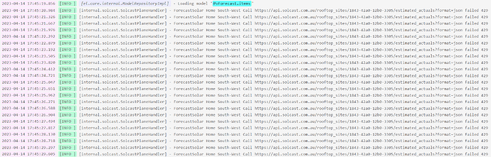

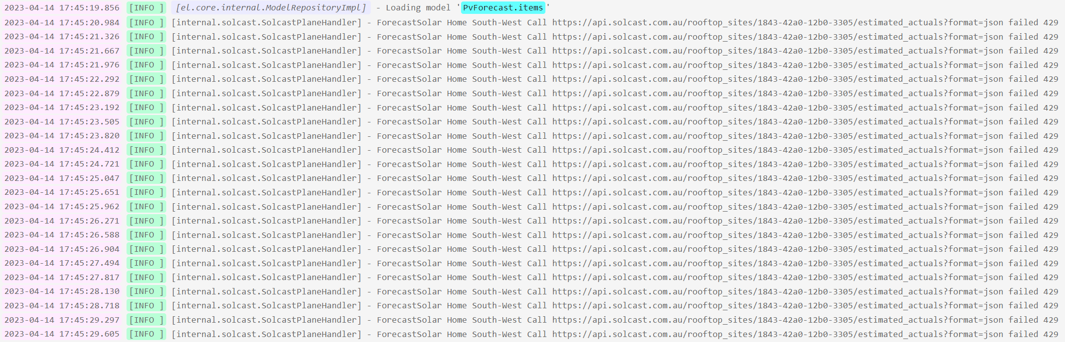

Just upgraded to OH3.4.3 and now all Solar Forcast Items show NULL value.
(I’m using one “fs-site” and one “sc-site” thing)
The binding worked well until the upgrade.
The log shows these messages regarding Solar Forecast:
Did the OH server simply “fire” to many requests to the Solcast API?
The API manual reads:
“429 Too Many Requests The request exceeds the available rate limit at your current subscription level.”
Are there any ideas as to the cause of the issue or what I could do to fix this issue?

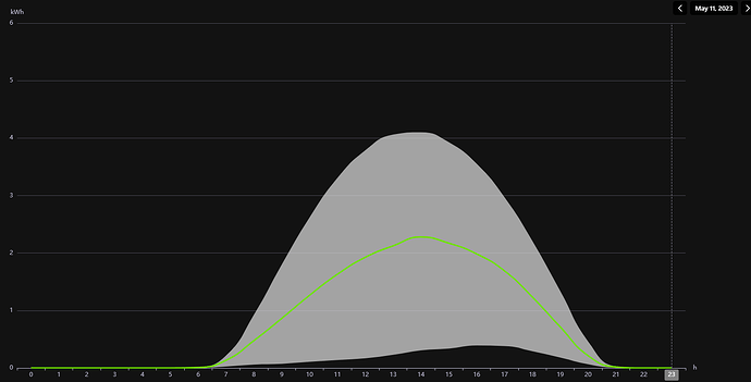

Hi Ward,
Do you have by chance the same code ready for the Solcast forecast? Really great to have the forecast visualized in Grafana in order to be able to see how it fits over the day to the upcoming real values.
On a quick check, Solcast provides much more realistic values for my case compared to Forecast Solar. Not sure if I have setup something incorrectly by Forecast Solar, but I couldn´t find a failure yet.
I also switched to Solcast last week, because the values from Forecast Solar were not correct anymore.
but I didn’t changed my script to add these values in influxdb. Maybe I’ll check in the next days. Keep you posted.
I had the same problem. The solution was to change the refresh interval to 120 in the solcast bridge of solar forecast pv.
Done :slight_smile:

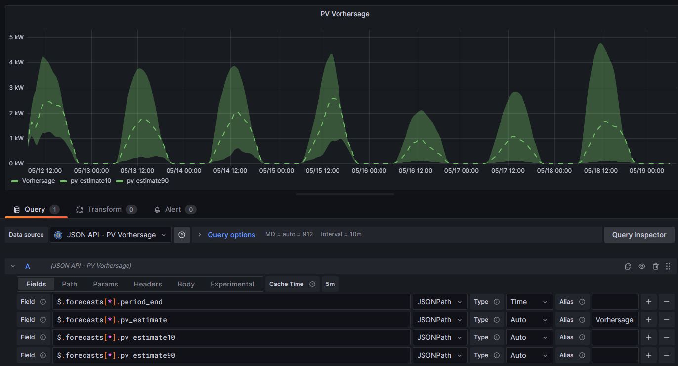

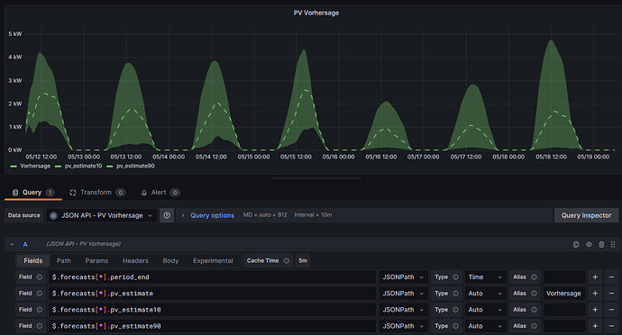

By the way, in the meanwhile I found an alternative solution for getting the data into Grafana which might be interesting for you as well. They can be read into Grafana via the JSON API. The disadvantage is, that there the data are not stored permanently. The advantage on the other side is, that it shows always the latest data in the forecast.
To set it up, you need to install the JSON API as data source in Grafana. As URL you set the link to your RAW-Forecast item of the openHAB REST API. You can easily find it via the API Explorer under the development tools in openHAB. It looks like the following example: “https://XXX.XXX.XXX.XXX:XXXX/rest/items/PV_Vorhersage_Solcast_Sued_RAWJSON/state”
Then you activate Basic Authentification and apply your openHAB login credentials for authentification.
Within Grafana, the data can be used as follows:
