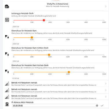

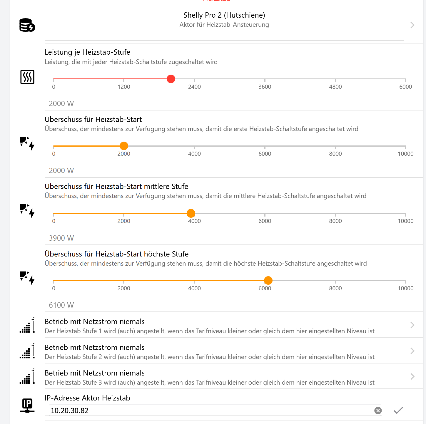

An often requested setup for HEMS usage is heating rods, that’s about the same like your boiler.
Most are on-off or have two inputs to signal levels 0-3.
Here’s how that looks like in my HEMS config UI (I guess you can translate the text yourself if needed).
