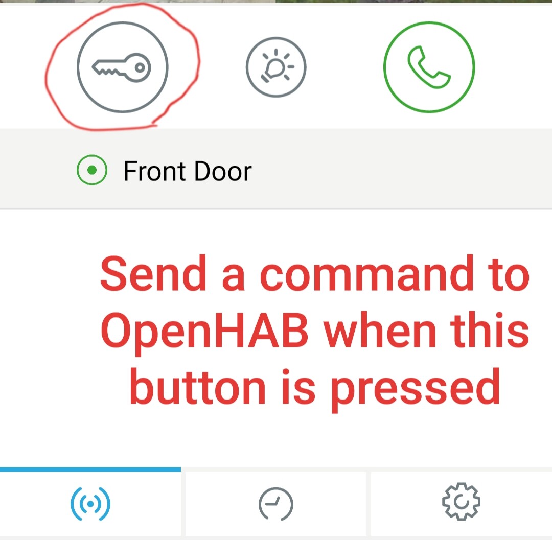

I have owned a Doorbird video doorbell for a while, and have been very happy with it!
One thing that bothered me, however, was that I could not [figure out how to] use the ‘Unlock’ button in the Doorbird app to unlock my ZWave door lock - I finally got it working, with a lot of help from this thread and thought I would post the solution - it’s actually remarkably simple!
The Doorbird binding uses the UDP packets sent by Doorbird, and since these don’t contain the relay state, the binding cannot trigger an event based on the relay button press in the Doorbird app. In fact, you don’t need to have the Doorbird binding installed to get the ‘Unlock’ button to trigger an action in OpenHAB, but it’s a great binding for other tasks, so you should go ahead and install it anyway!

  1. Head to https://webadmin.doorbird.com/login, and log in, using the administrator details that you received in your Doorbird box (or get them from your app).
    Click on ‘Favourites’ > ‘HTTP(S) Calls’. Click on ‘Add’. Name the call whatever you like, I went with ‘OpenHAB Relay’. The URL should be as below, using your values (NB: can be an HTTP call, in which case you’d use port 8080, but I’m assuming you’ll use HTTPS since Doorbird supports it). Click save.
https://[your_openHAB_ip]:8443/basicui/CMD?Doorbird_Relay_Callback=ON
NB: If you are using the Classic UI (only), then swap ‘basicui’ for ‘classicui’ above.
  1. Click on ‘Expert Settings’ > ‘Relays’ > ‘Schedule for follow up actions’. Select the favourite you just made, and then click the box near the top right of the window to make it active at all times (or alternatively, enable it only at certain times, if you prefer). Click save.
  2. Try it out! Open a log viewer (http://[your_openHAB_ip]:9001), and pull up the Doorbird app on your phone. Press the unlock button, and you should see log entries showing your dummy item is updated, and that your rule has fired! Your door (or whatever) should now be unlocked! You could also do something like turn on the porch / vestibule / hallway lights in the rule if you like. If it’s all working, you can logout from the Doorbird webadmin page.
