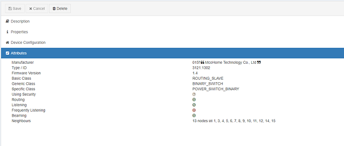

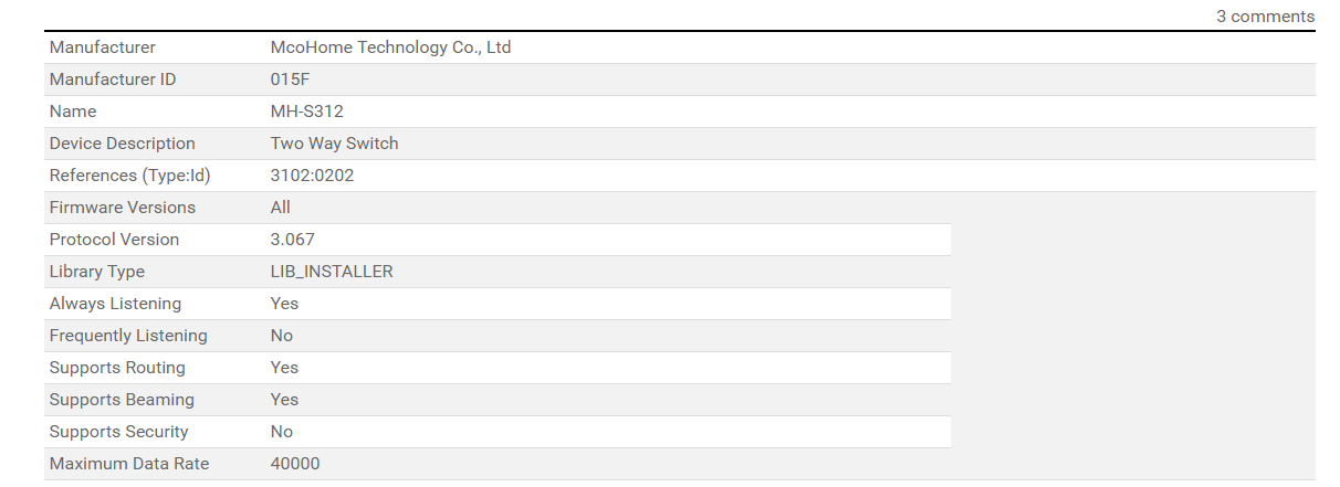

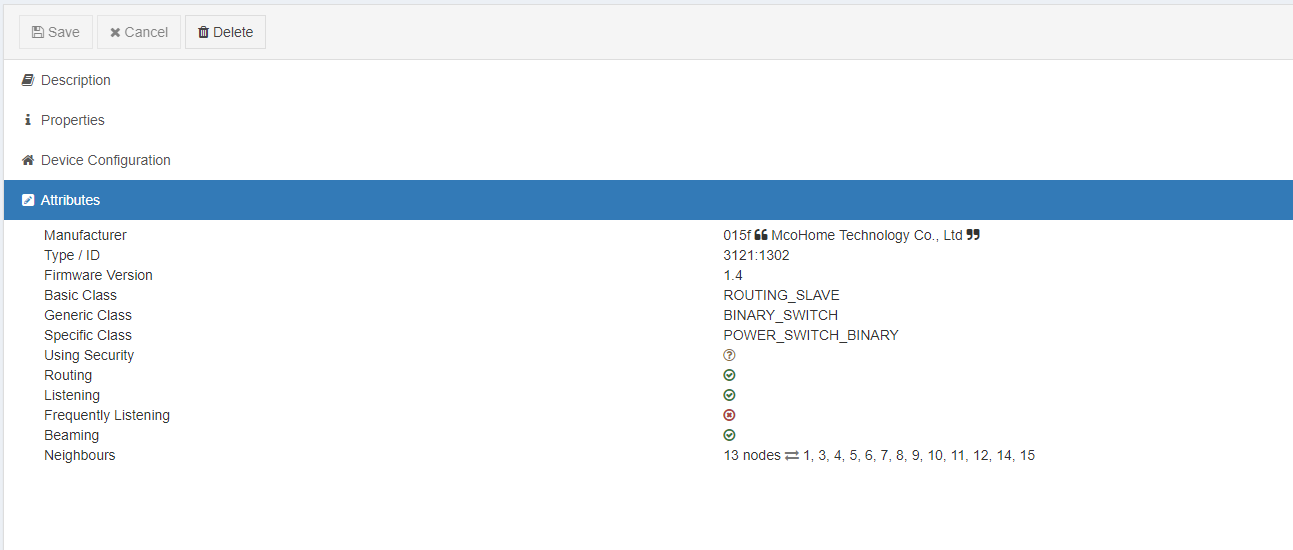

bradhab
(Brad)
December 8, 2017, 1:45pm
9
Hi Mark,
I have exactly the same problem with another device.
MH-S312
The database shows
References (Type:Id) 3102:0202
However mine are 3121:1302
Any chance you can help?
Thanks!
mhilbush
(Mark)
December 8, 2017, 1:58pm
10
The db change I made for this device has not made it into a zwave build yet.

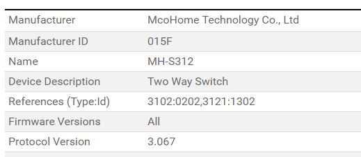

mhilbush
(Mark)
December 8, 2017, 2:03pm
11
I just updated the database.
Keep in mind that:
my db change needs to be approved by @chris , after which
the change will be included in the next build of the zwave binding
you will need to upgrade to the latest zwave binding (easy if you are running a snapshot build)

(Brad)
December 9, 2017, 1:52pm
17
Update:
Following your update, switched my openhabian install from 2.1 stable to lastest snapshot using sudo openhabian-config
Zwave binding has updated and my device MH-S312 working perfectly.
Much appreciated Mark and Chris
