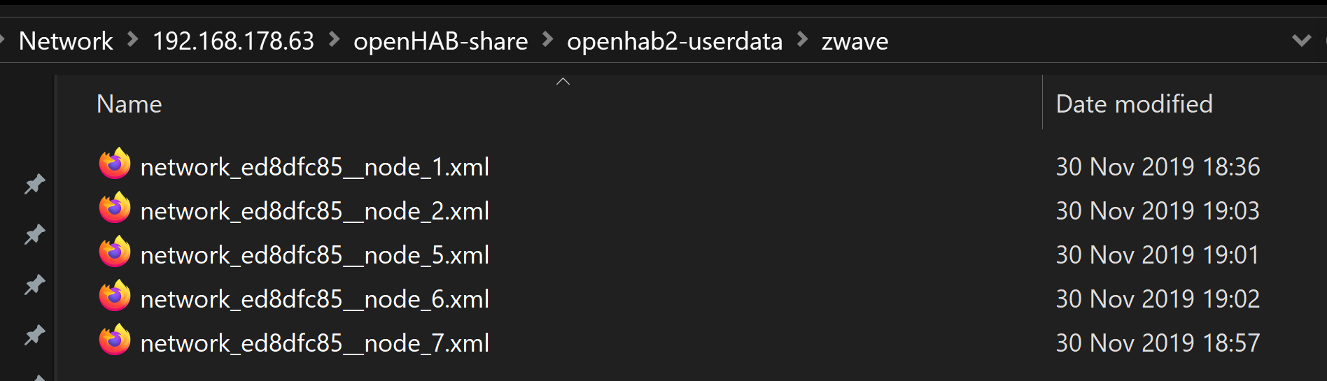

Additionally: My devices have IDs 3, 4 and 9. I re-flashed my Pi and set up OpenHab again to have a fresh start. There is currently no file for those in the zwave folder:
Is there a way to force the writing of those files?

Yes - you need to reinitialise the device - once the reinitialisation is complete it will be rewritten. You can’t force it to rewrite the file if it doesn’t have the data - hence it only does it once the initialisation is done.
