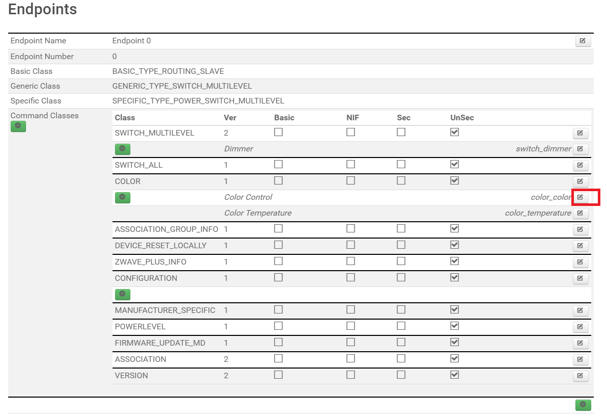

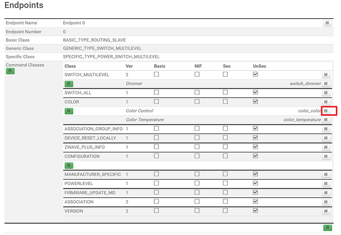

There is an error in the database - the color_color channel should have some information configured -:
Can you have a quick look at this and compare it to the older bulb - there should be a mode=RGB or something like that added to the Config box.
@chris
Happy to. Where am I looking? On Paper UI? HABMin or the Database entry?
I think here: https://www.cd-jackson.com/index.php/zwave/zwave-device-database/zwave-device-list/devicesummary/949
Yup YUP!
Thanks. I have added
colorMode=RGB
I checked color_temperature and it is the same as the older device.
Anything else I should look for?
Cheers! :slight_smile:
=C=
Thanks - I will try and get that into the binding tonight, but it might be tomorrow…
