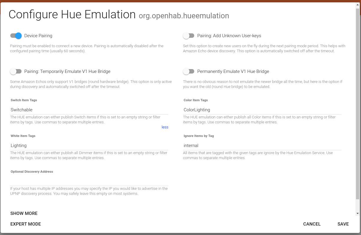

The reason I don’t think it may be supported is that it doesn’t show up in the documentation or even on the setup screen here.

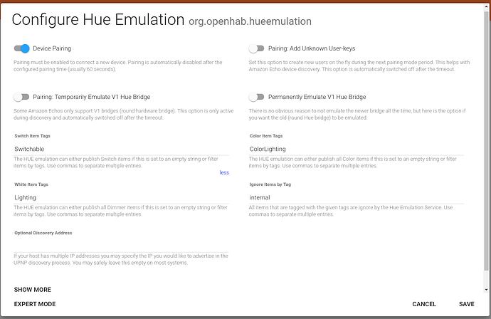

Did you click on “show more” in bottom left of screen?
@fifo I don’t remember if hue emulation supports it or not. When I used it it is possible I was using through my openHAB. I know it worked with my google also. Maybe I am mixing. Something up.
The “Show More” just adds options for Timeout, Optional Discovery Web Port , and Unique Bridge ID. :frowning: The Expert Mode also just shows the same options but in a more advanced user format. Maybe this was supported at one point in time but no longer?
