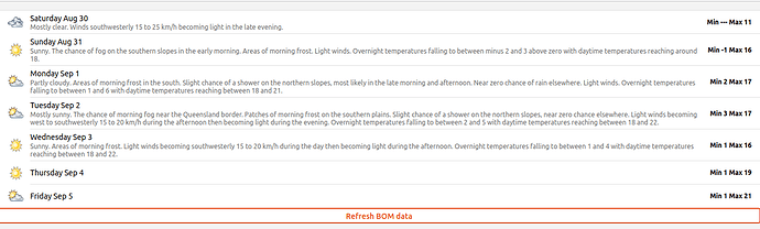

My BOM program is nothing fancy but it does the job.
I did a quick and dirty widget the other day and haven’t got back to finishing it but it looks like this so far:
