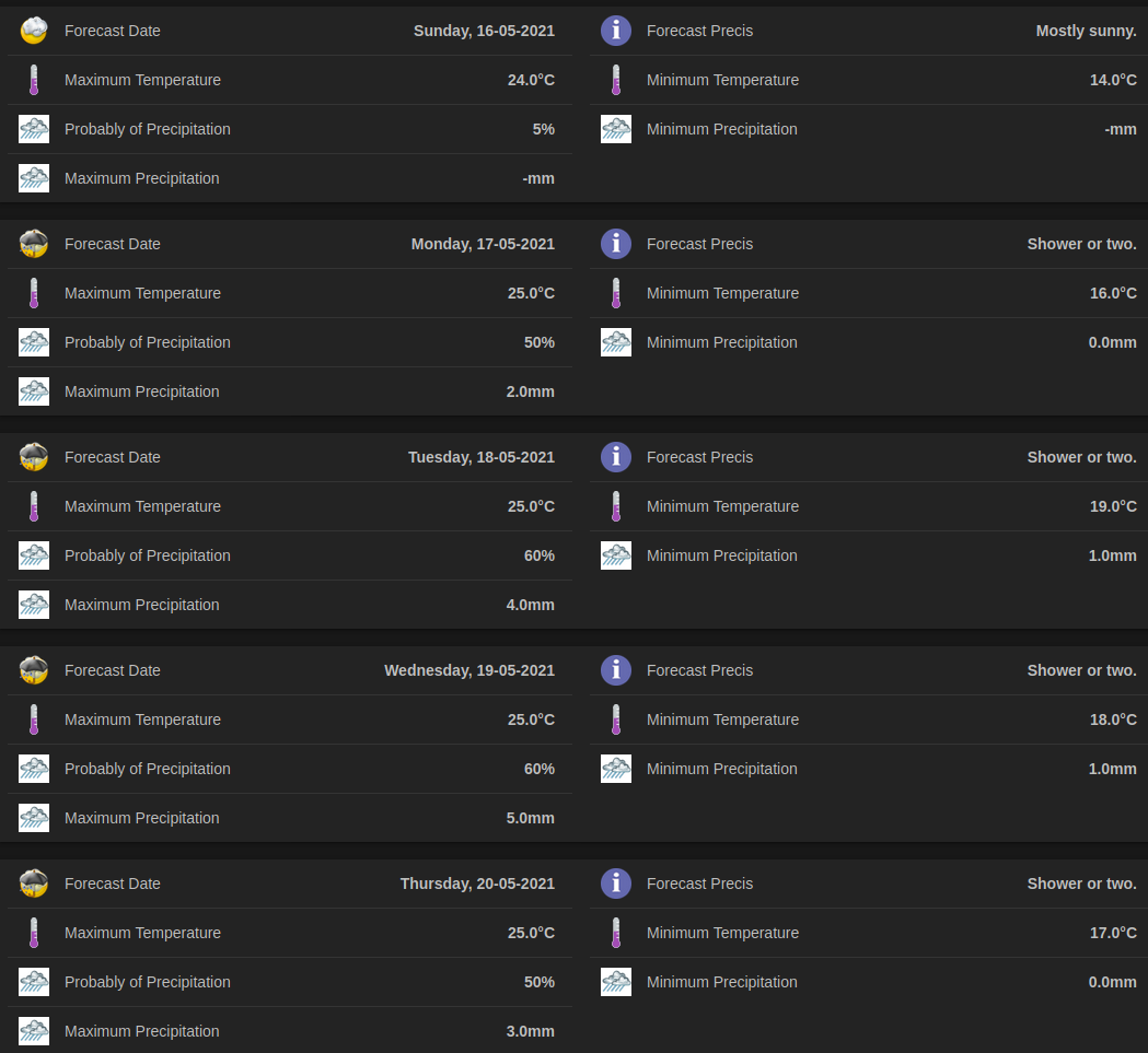

OK, notice a few problems with 3.0.3 version:
  • mixing up daily and precis sections.

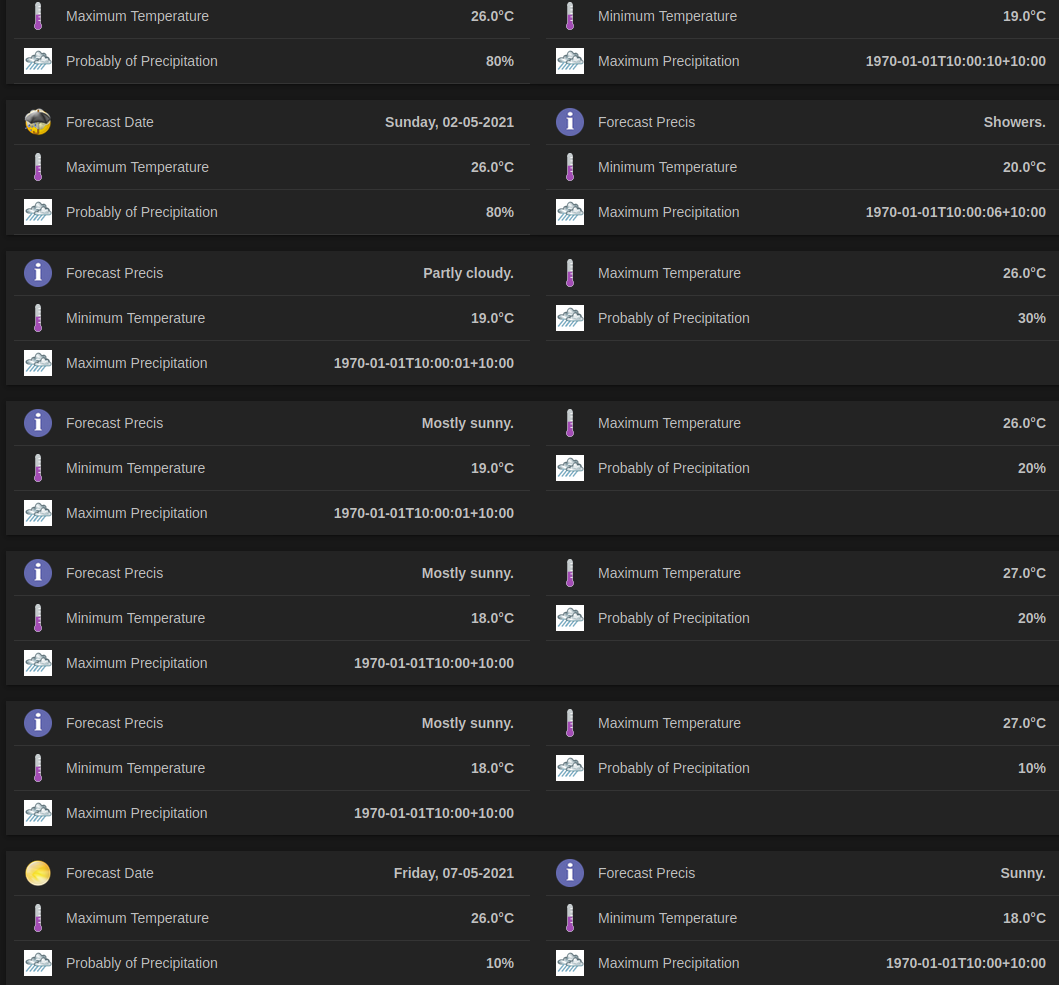

  • Maximum Precipitation is showing up as a date (unix time beginning)

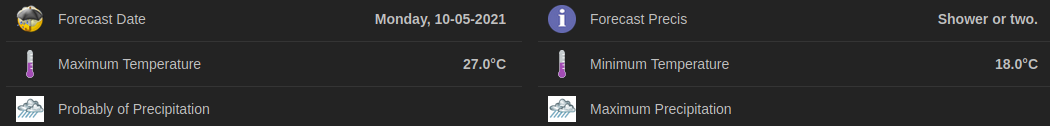

Old output:

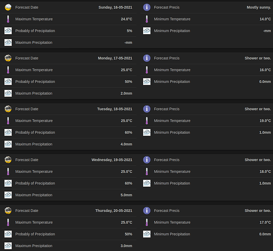

Current output:

Could you pass me your configuration? I can’t see any issue for my location.
Sure Thomas (@tomitan). Where does the binding save the downloaded xml files, or does it do all the parsing in memory ?

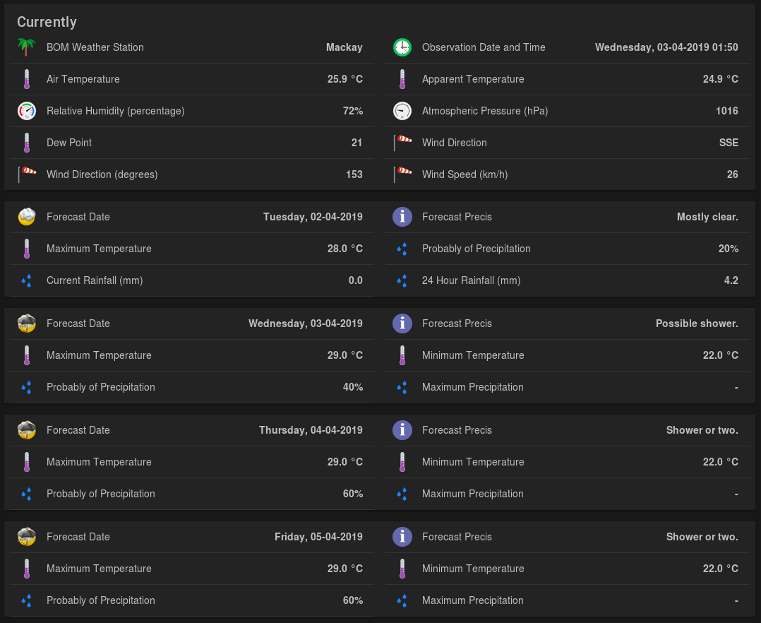

Sitemap: (commented entries are either not available or I’m not interested in them)
                Group item=wForecast {
                        Frame label="Currently" {
                                Text    item=BOM_Day1_WeatherStation
                                Text    item=BOM_Day1_ObservDateTime
                                Text    item=BOM_Day1_AirTemperature
                                Text    item=BOM_Day1_ApparentTemperature
                                Text    item=BOM_Day1_RelHumidPercent
                                Text    item=BOM_Day1_AtmosPressureHPa
                                Text    item=BOM_Day1_DewPoint
                                Text    item=BOM_Day1_WindDirection
                                Text    item=BOM_Day1_WindDirectionDeg
//                              Text    item=BOM_Day1_WindSpeedKnots
                                Text    item=BOM_Day1_WindSpeedKmH
                        Frame {
                                Text    item=BOM_Day1_ForecastDateTime icon="weather_sunny_32" visibility=[BOM_Day1_ForecastIcon=="sunny"]
                                Text    item=BOM_Day1_ForecastDateTime icon="weather_clear_32" visibility=[BOM_Day1_ForecastIcon=="clear"]
                                Text    item=BOM_Day1_ForecastDateTime icon="weather_mostly_sunny_32" visibility=[BOM_Day1_ForecastIcon=="mostly-sunny"]
                                Text    item=BOM_Day1_ForecastDateTime icon="weather_cloudy_32" visibility=[BOM_Day1_ForecastIcon=="cloudy"]
                                Text    item=BOM_Day1_ForecastDateTime icon="weather_hazy_32" visibility=[BOM_Day1_ForecastIcon=="hazy"]
                                Text    item=BOM_Day1_ForecastDateTime icon="weather_light_rain_32" visibility=[BOM_Day1_ForecastIcon=="light-rain"]
                                Text    item=BOM_Day1_ForecastDateTime icon="weather_windy_32" visibility=[BOM_Day1_ForecastIcon=="windy"]
                                Text    item=BOM_Day1_ForecastDateTime icon="weather_fog_32" visibility=[BOM_Day1_ForecastIcon=="fog"]
                                Text    item=BOM_Day1_ForecastDateTime icon="weather_shower_32" visibility=[BOM_Day1_ForecastIcon=="shower"]
                                Text    item=BOM_Day1_ForecastDateTime icon="weather_rain_32" visibility=[BOM_Day1_ForecastIcon=="rain"]
                                Text    item=BOM_Day1_ForecastDateTime icon="weather_dusty_32" visibility=[BOM_Day1_ForecastIcon=="dusty"]
                                Text    item=BOM_Day1_ForecastDateTime icon="weather_frost_32" visibility=[BOM_Day1_ForecastIcon=="frost"]
                                Text    item=BOM_Day1_ForecastDateTime icon="weather_snow_32" visibility=[BOM_Day1_ForecastIcon=="snow"]
                                Text    item=BOM_Day1_ForecastDateTime icon="weather_storm_32" visibility=[BOM_Day1_ForecastIcon=="storm"]
                                Text    item=BOM_Day1_ForecastDateTime icon="weather_light_shower_32" visibility=[BOM_Day1_ForecastIcon=="light-shower"]
                                Text    item=BOM_Day1_ForecastDateTime icon="weather_heavy_shower_32" visibility=[BOM_Day1_ForecastIcon=="heavy-shower"]
                                Text    item=BOM_Day1_ForecastDateTime icon="weather_cyclone_32" visibility=[BOM_Day1_ForecastIcon=="cyclone"]
                                Text    item=BOM_Day1_ForecastDateTime icon="weather_na_32" visibility=[BOM_Day1_ForecastIcon==""]
//                              Text    item=BOM_Day1_ForecastIcon
                                Text    item=BOM_Day1_ForecastPrecis
//                              Text    item=BOM_Day1_ForecastDescription
//                              Text    item=BOM_Day1_MinimumTemperature
                                Text    item=BOM_Day1_MaximumTemperature
                                Text    item=BOM_Day1_ProbOfPrecipitation
                                Text    item=BOM_Day1_CurrentRainfallMm
                                Text    item=BOM_Day1_Rainfall24HourMm
//                              Text    item=BOM_Day1_MinimumPrecipitation
//                              Text    item=BOM_Day1_MaximumPrecipitation
//                              Text    item=BOM_Day1_UVAlert
                        Frame {
                                Text    item=BOM_Day2_ForecastDateTime icon="weather_sunny_32" visibility=[BOM_Day2_ForecastIcon=="sunny"]
                                Text    item=BOM_Day2_ForecastDateTime icon="weather_clear_32" visibility=[BOM_Day2_ForecastIcon=="clear"]
                                Text    item=BOM_Day2_ForecastDateTime icon="weather_mostly_sunny_32" visibility=[BOM_Day2_ForecastIcon=="mostly-sunny"]
                                Text    item=BOM_Day2_ForecastDateTime icon="weather_cloudy_32" visibility=[BOM_Day2_ForecastIcon=="cloudy"]
                                Text    item=BOM_Day2_ForecastDateTime icon="weather_hazy_32" visibility=[BOM_Day2_ForecastIcon=="hazy"]
                                Text    item=BOM_Day2_ForecastDateTime icon="weather_light_rain_32" visibility=[BOM_Day2_ForecastIcon=="light-rain"]
                                Text    item=BOM_Day2_ForecastDateTime icon="weather_windy_32" visibility=[BOM_Day2_ForecastIcon=="windy"]
                                Text    item=BOM_Day2_ForecastDateTime icon="weather_fog_32" visibility=[BOM_Day2_ForecastIcon=="fog"]
                                Text    item=BOM_Day2_ForecastDateTime icon="weather_shower_32" visibility=[BOM_Day2_ForecastIcon=="shower"]
                                Text    item=BOM_Day2_ForecastDateTime icon="weather_rain_32" visibility=[BOM_Day2_ForecastIcon=="rain"]
                                Text    item=BOM_Day2_ForecastDateTime icon="weather_dusty_32" visibility=[BOM_Day2_ForecastIcon=="dusty"]
                                Text    item=BOM_Day2_ForecastDateTime icon="weather_frost_32" visibility=[BOM_Day2_ForecastIcon=="frost"]
                                Text    item=BOM_Day2_ForecastDateTime icon="weather_snow_32" visibility=[BOM_Day2_ForecastIcon=="snow"]
                                Text    item=BOM_Day2_ForecastDateTime icon="weather_storm_32" visibility=[BOM_Day2_ForecastIcon=="storm"]
                                Text    item=BOM_Day2_ForecastDateTime icon="weather_light_shower_32" visibility=[BOM_Day2_ForecastIcon=="light-shower"]
                                Text    item=BOM_Day2_ForecastDateTime icon="weather_heavy_shower_32" visibility=[BOM_Day2_ForecastIcon=="heavy-shower"]
                                Text    item=BOM_Day2_ForecastDateTime icon="weather_cyclone_32" visibility=[BOM_Day2_ForecastIcon=="cyclone"]
                                Text    item=BOM_Day2_ForecastDateTime icon="weather_na_32" visibility=[BOM_Day2_ForecastIcon==""]
//                              Text    item=BOM_Day2_ForecastIcon
                                Text    item=BOM_Day2_ForecastPrecis
//                              Text    item=BOM_Day2_ForecastDescription
                                Text    item=BOM_Day2_MaximumTemperature
                                Text    item=BOM_Day2_MinimumTemperature
                                Text    item=BOM_Day2_ProbOfPrecipitation
//                              Text    item=BOM_Day2_MinimumPrecipitation
                                Text    item=BOM_Day2_MaximumPrecipitation
//                              Text    item=BOM_Day2_UVAlert

EDIT: the Maximum Pecipitation is still showing up as a date (onlly in 3.0.3 version, in 3.0.0 it just comes up blank).
3.0.0
3.0.3
Glad it is mostly working for you. I’ll investigate the max precipitation issue.

As for you other problem, max (and min) precipitation is a number. Can you try configuring it as a number?
ie.
String BOM_Day2_MaximumPrecipitation "Maximum Precipitation"
to
Number BOM_Day2_MaximumPrecipitation "Maximum Precipitation"
Also download and install the latest version as I have made a slight change to the output format for min and max a few minutes ago.

Using the latest binding version I changed to Number (tried floats and integers), then noticed in the downloaded xml files (I figured they’d come in handy, lol) one of the entries had a float (0.4), so went with that. Items now read as:
Number BOM_Day2_MinimumPrecipitation    "Minimum Precipitation [%.1fmm]"  .....
Number BOM_Day2_MaximumPrecipitation    "Maximum Precipitation [%.1fmm]"   .....
Also noticed in the xml files there are no “precipitation_range” data in the first 4 or 5 days, so much of the problems could stem from that. I’m sure they used to have that data, I might have to contact BOM and clarify.
Here’s a pic showing when the data becomes available:
Thanks again for all the work you’re doing Thomas and being so supportive.
Personally I have never seen precipitation range for the today’s forecast. There are other fields sometimes unavailable as well.
