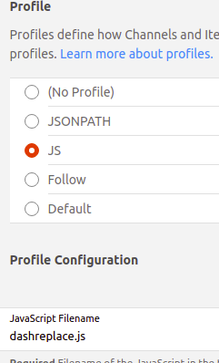

Also because the dashes from the bom addon are not supported you have to use underscores.
To do this install transform javascript Restart openhab after installing the transform
Then under the transforms directory create a javascript file and call it dashreplace.js:
(function(i) {
return i.replace(/-/g,‘_’);
})(input)
save the file
The go to the BOM_Day1_ForecastIcon item and find the profile JS and then add the name dashreplace.js in there. Like below.

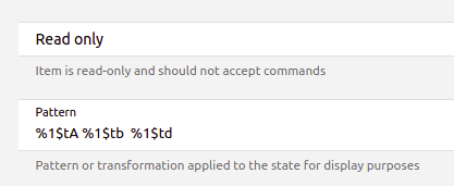

Also in the date for the BOM_Day1_ForecastDateAndTime etc you have to put in the date format you want in the metadata state description
I used %1$tA %1$tb %1$td

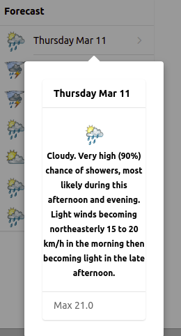

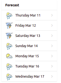

Then you will be able to do things like this:
The code for the above looks similar to this:
component: oh-label-card
  title: =(items.BOM_Day2_ForecastDateAndTime.displayState)
  footer: ="Min " +" "+(items.BOM_Day2_MinimumTemperature.state) + "  Max "
    +(items.BOM_Day2_MaximumTemperature.state)
  item: BOM_Day2_ForecastDescription
  fontSize: 12px
  fontWeight: bold
  icon: ="oh:"+(items.BOM_Day2_ForecastIcon.state)
  vertical: true
Good luck.

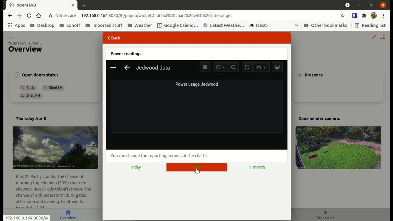

Here is my overview page with the weather on it.
I think it is better than the site map way.
