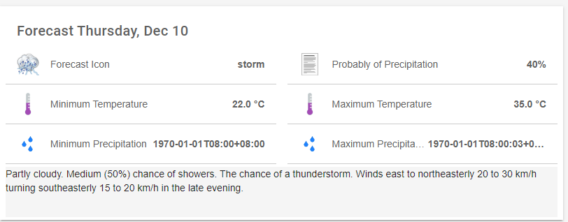

@tomitan Great plugin thanks! I had my own ftp extraction tool and http bindings but this was mess. This plugin makes it easier. I have noticed that I am getting a datetime object in the Min/Max Precipitation values like this:
I have done some fancy scripting and webviews to make this work in BasicUI but the values in the Min/Max are coming in for this particular day (tomorrow) that has a rain forecast.

Thursday is Day2 so the Items for this are:
String BOM_Day2_MinimumPrecipitation "Minimum Precipitation [%s]" <rain> {channel="bom:weather:default:day2#minPrecipitation"}
String BOM_Day2_MaximumPrecipitation "Maximum Precipitation [%s]" <rain> {channel="bom:weather:default:day2#maxPrecipitation"}
In the BOM ftp file IDW14199.xml I am pulling out WA_PT058 and for this day the record looks like this:
          <forecast-period index="2" start-time-local="2020-12-10T00:00:00+08:00" end-time-local="2020-12-11T00:00:00+08:00" start-time-utc="2020-12-09T16:00:00Z" end-time-utc="2020-12-10T16:00:00Z">
                <element type="forecast_icon_code">16</element>
                <element type="precipitation_range">0 to 3 mm</element>
                <element type="air_temperature_minimum" units="Celsius">22</element>
                <element type="air_temperature_maximum" units="Celsius">35</element>
                <text type="precis">Possible shower or storm.</text>
                <text type="probability_of_precipitation">40%</text>
            </forecast-period>
It shows a range of 0 to 3 mm which I assume should be what I am getting into Openhab?

Hi guys, I will look into OH3 compatibility and other issues soon.
Guys, the openHAB3 version of the binding is now available here: BOM binding v3
Let me know if there is any problem.
David, please try the recently updated v2.5.9.
Or v3.0.0 if you are using openHAB3.

Thank so much for the updated binding.
I downloaded the 3.0 JAR and popped it into the ADDONS folder and it is working well. I did have to restart openHAB (with a clean-cache for good measure) as the JAR didn’t seem to get picked up initially, which I don’t seem to remember doing for 2.0, but otherwise it’s working well.
