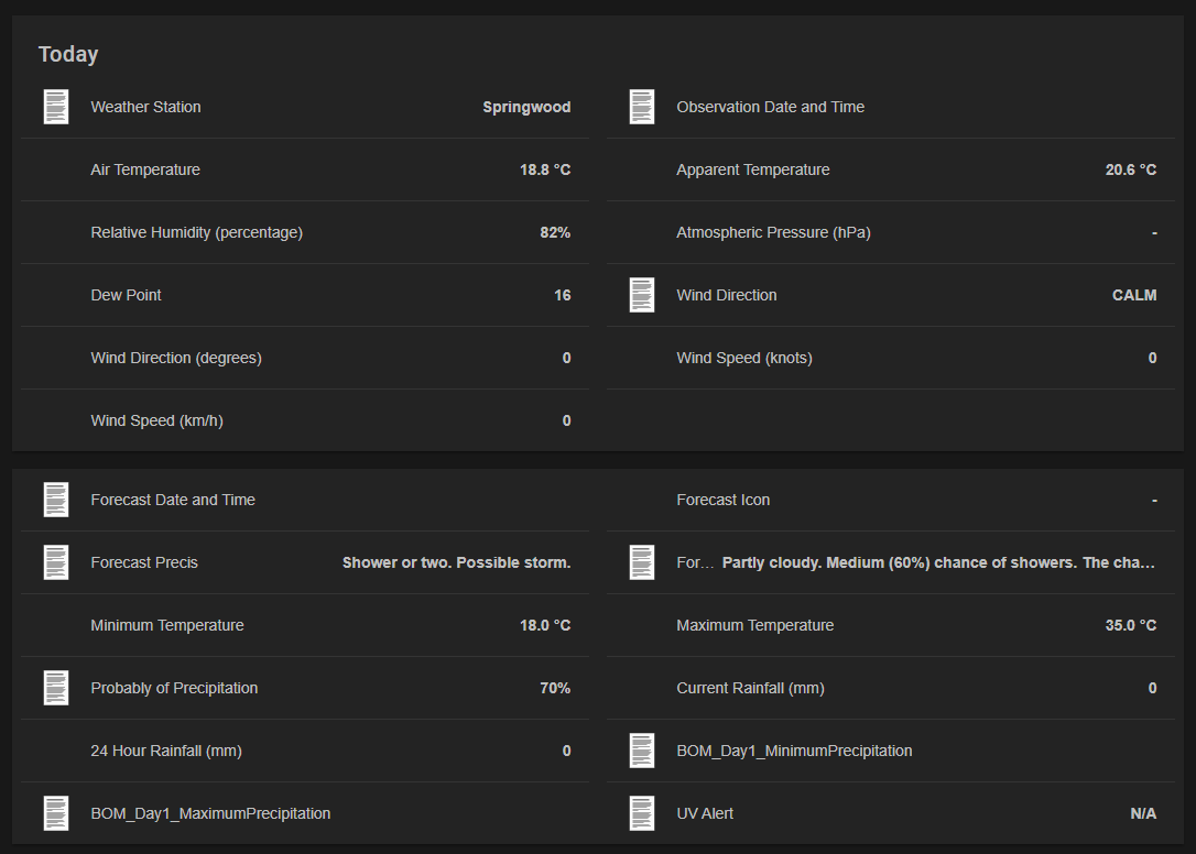

ok cheers. I’m now not getting any data.
I’ve checked the ID’s and everything is correct, so not sure why it’s not working :confused:

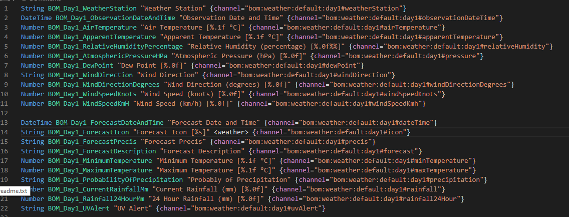

So I’ve noticed that when i modify the forecast icon line with , it removes the data to get the screenshot above.
Am i doing it right?
String BOM_Day1_ForecastIcon “Forecast Icon” <‘weather’> {channel=“bom:weather:default:day1#icon”}
without the ’ ’ though.
and then once it goes, even removing <weather> doesn’t bring the data back again, no matter how many times I refresh it.
should be
String BOM_Day1_ForecastIcon “Forecast Icon [%s]” <‘weather’> {channel=“bom:weather:default:day1#icon”}
The [%s] is important, it’s a placeholder for the return message.
I’m not the best to explain the workings of the binding itself, I just came up with the sitemap to display the icon matching the conditions. Best to call up tomitan for the binding stuff.
No worries I’ll give it a go. I’ve also tried your python file, it kept saying ImportError urrlib.request and wouldn’t run.. not sure what to do.
Hey there, sorry to disturb. I’m having trouble getting the icons to work. @rastus_rob has been trying to help but this keeps happening when I add in the <weather> tag:
This is what I have for the item binding:
Not sure what I am doing wrong! Only had OpenHAB running a week or so, so am definitely still learning!

I had a look at the icons provided by Rob, they will not work for you out of the box. If you would like dynamic icons to work the filenames must be named a certain way.
Please read Items | openHAB for more info.
I believe Rob has some logic to work out which icon to use (see earlier post back in 1/4/2019) , but I suggest you use the dynamic icons way.
As a quick test that the page will show icons, replace <weather> with <weather_cloudy_32>. If you do not see an icon then most likely the icon file cannot be found. Once you are satisfied change back to <weather> and rename all those files accordingly.
Let me know you are still not getting data. You might have to wait a while or restart openHAB.
