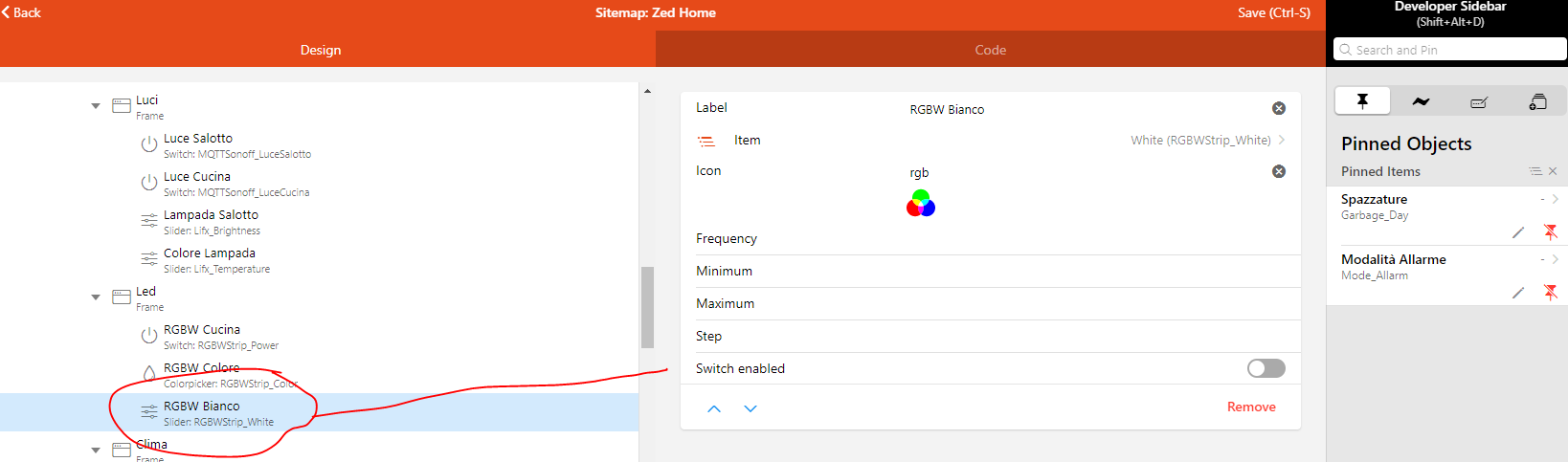

Hello Oliver,
I’m not able to find that option again, I search 2h to give you the correct answer, but nothing =(
I’m struggling a lot with OH3 now UI. sorry again, maybe some one can help us to find that option called
“Switch Enabled” again…
I had similar issues with the sitemap in OH3.
The workaround I found is the same as already described here (disable switch), however I think I might have also found the reason for this behavior.
In the code section, with the switch enabled, you’ll have something like this (slider in my example):

So something’s trying to convert a string to a boolean value, and the exception is not thrown when I remove the switchEnabled="true" part. So I’m pretty sure the problem is, that it’s "true" instead of just true.
Unfortunately, the editor doesn’t let one save the file without the "" (you can click save, but on reloading they’re back).
In the generated JSON, the quotation marks also show up, so maybe this is an issue in the conversion to JSON and back?
