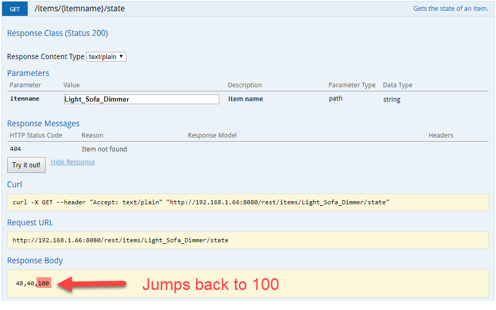

I did not use/check this for a long time now, but I have a very strange behaviour with Philips Hue Bulp Type 210 in the latest snapshot and as well in Milestone M3:
  • I’m not able to control anymore the brightness in BasicUI with Colorpicker-Slider → Bulp doesn^t change anything
  • I can control the Brightness from Paper-UI Control-Panel but the value jumps back to 100 after next refresh (according refresh-interval) → See video
  • REST-Interface does show the same → Value jumps back to 100
  • In addition I do not get the same colors as in the past by sending a command out of my rules: Light_Sofa_Dimmer.sendCommand(“30,64,60”)
It seems that this bug is only related to the color-bulps and lightstrips.
Video:
The question is now if I’m the only one? Or is this really a bug? Does someone else have this setup and is able to check before I create an issue on Github?
