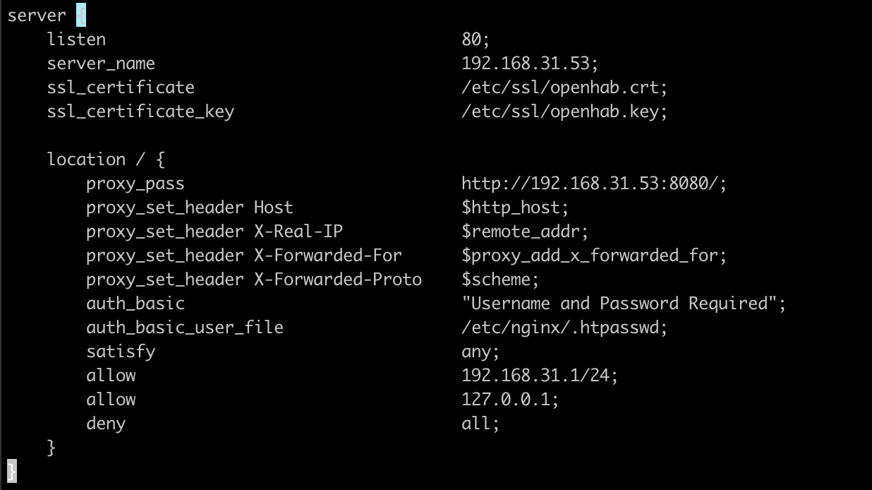

If in case, below is my ngnix config file.

ngnix test command was giving me a warning about “lower address bits are meaningless” so i changed From
allow 192.168.31.1/24
To
allow 192.168.31.0/24
and restarted the ngnix. Warning disappeared but still problem persists. Just thinking if i need to completely remove ngnix and check.
