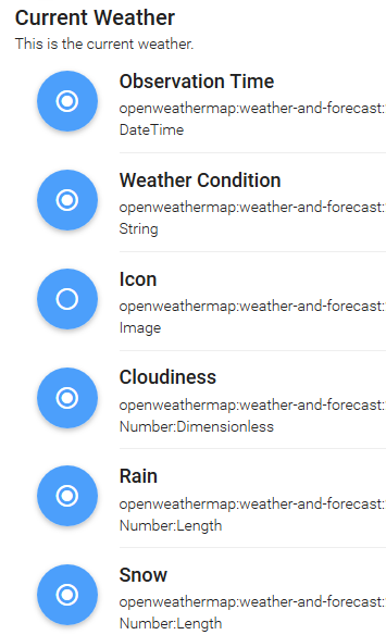

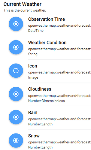

Forgot to mention that I can only see the following channels under “current weather” section. As you can see the current temperature is not there :disappointed:
Older versions (e.g. for OH2.3 release) are not supported anymore.

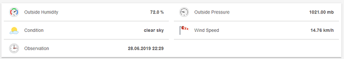

I have experienced the same issue with the Weather Binding and OpenWeatherMap as a provider (API error messages in the log). After switching to ForecastIo / Dark Sky API, everything works fine, no error messages related to API. Dark Sky free API is much more generous than OpenWeatherMap’s one.
When I added location, e.g. location my-home. in weather.cfg (/etc/openhab2/services) and later on changed it to location.home my openhab.log has been flooded with errors, like “there is no location my-home”. For some reasons, /var/lib/openhab2/config/org/openhab/weather.cfg contains all old, removed from the /etc/openhab2/services/weather.cfg, records. After cleaning it, my weather binding works as expected.
Just in case, if someone, like I was, is struggling with the html part, which is really nice when it works and added to the HABpanel as a frame widget:
  1. /var/lib/openhab2/webapps/weather-data/layouts/example.html
  2. /etc/openhab2/html/weather-data/images
  3. /etc/openhab2/html/weather-data/layouts
example.html (in both locations):
prepend /static/ to everything that starts with /weather-data (href, src)
