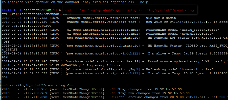

Yes, this is why I said to look into openhab.log - in the same folder. events.log is useful for looking at e.g. Item changes, openhab.log is useful for looking at software reports. If you get nothing, your logging is broken. But you seem to say there is something - “info”, whatever that may be.
May we see a sample of what you are looking at?

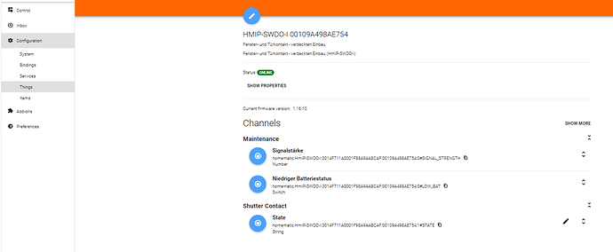

the type of item for contact needs to be a string type, the changed events are triggered now
I have not installed the frontail logger, i use log:tail in the karaff console, how can I do install the logger?
with tail -f /var/log/openhab2/openhab.log the log is displayed in the console.
here is the info of my homematic device after I have changed the type of item to string like fibu-freak adviced. Debug level for homematic binding is still activ, I expected some more details though ??
as a workaround. 'til you found a way to integrate “frontail”. Maybe @rossko57 knows a solution.

The “more Info” about DEBUG you should see in the openhab.log

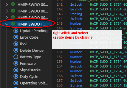

I’m not very experienced. What I can say is that it was not very hard to install the Bridge and the Things for the Homematic-Binding (ccu3) via Autodiscovery.
I have to say that it doesn’t work (for me) to create the Bridge and the Things with Text-Files in my OH2.5-M2.
After creating Bridge/Thing(Autodiscovery) you are able to create all the items with Channels for your special Homematic-Device via VSCode into a . items file. And I can say that’s a lot more than one can see in PaperUI.
