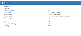

@JoeRu , you are not alone!
I’m also (to be) happy user of Danalock V3 / Z-Wave edition.
y-day switched over OH to a snapshot. Reinstalled Z-Wave “binding-zwave - 2.2.0.SNAPSHOT”. When searching for supported things, can see three entries w Danalock:
Danalock V3-BTZE Z-Wave Controlled door lock with Bluetooth Smart zwave:polycontrol_btze_01_002
BTZW125 Danalock v2 circle zwave:polycontrol_btzu125_00_000
Danalock V3-BTZE Z-Wave controlled door lock with Bluetooth Smart zwave:polycontrol_btze_00_000
The thing is found, but showing up as Unknown device. In the habmin interface Manufacturer and Type are empty (see attached picture)
In the openhab log there is:
[WARN ] [wave.discovery.ZWaveDiscoveryService] - NODE 10: Device discovery could not resolve to a thingType! 7FFFFFFF:7FFFFFFF:7FFFFFFF::0.0
@chris , I wonder, maybe device has corrupt/wrong metadata (Manufacturer empty)? Or development version is not the same as snapshot and I should be switching over to it for testing?

This probably means the device isn’t communicating. Are you sure you’re using the right version (ie the development version). It’s strange that the “Using security” box is a yellow question mark which leads me to think it’s the wrong version?

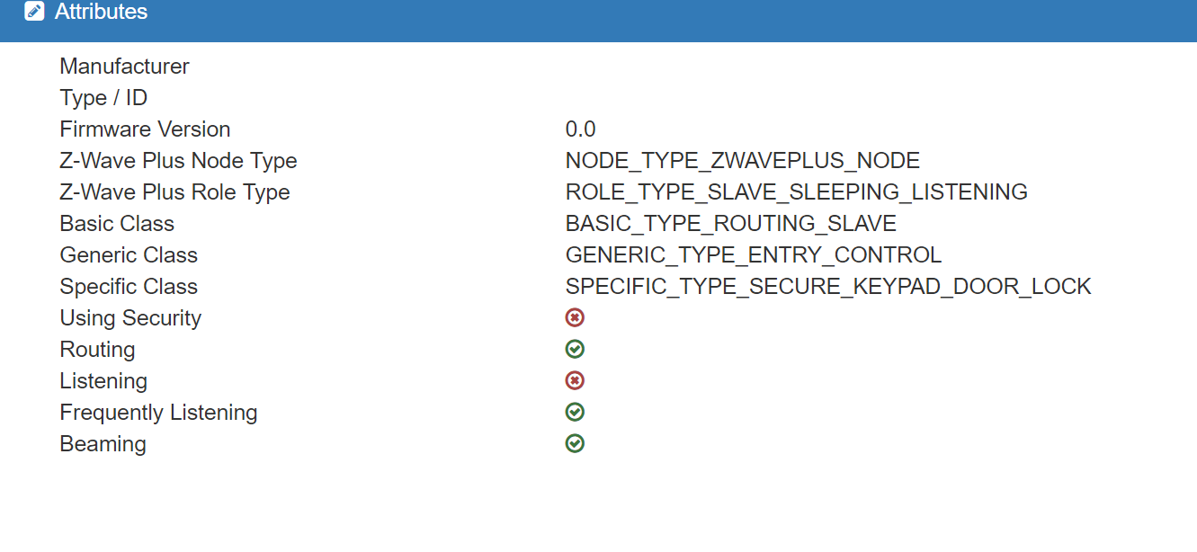

chris
(Chris Jackson)
October 25, 2017, 6:39pm
19
Austris_V:
is it better now?
Yes - it looks ok. I think you need to exclude node 10 and reinclude it again. Inclusion must be done through HABmin or PaperUI.

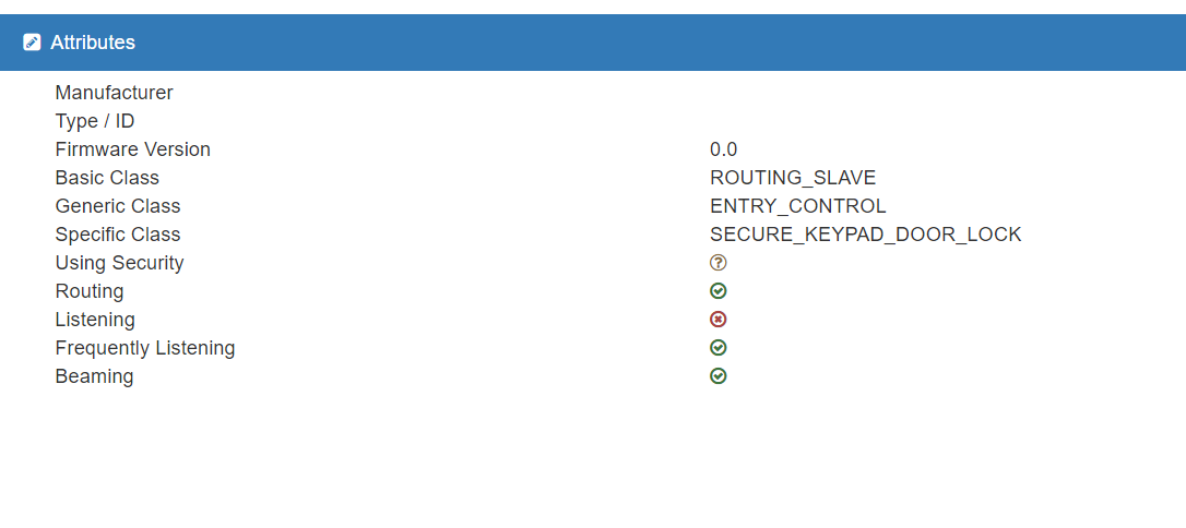

Austris_V
(Austris V)
October 25, 2017, 7:19pm
20
chris:
wow, I did not know it can be done through UI as well… giving it a try
here is log openhab.7z , Node 12 this time
