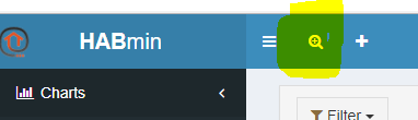

Start discovery of the Lock from HABmin interface (not from the stick) - by clicking
When Danalock thing discovered- add the thing. Assign item to channel, live with it :slight_smile:
