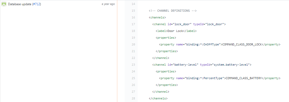

I’m not sure what mapping you are referring to exactly? Is this related to a channel definition, or the device itself?
If this is a firmware issue on the device, then I don’t think it’s related to the binding? Sorry - I’m not 100% sure still exactly what the issue is.
I just had a look at the channel definitions for the device, and they haven’t changed for a year -:
If the firmware is now different, maybe there’s an issue there?
