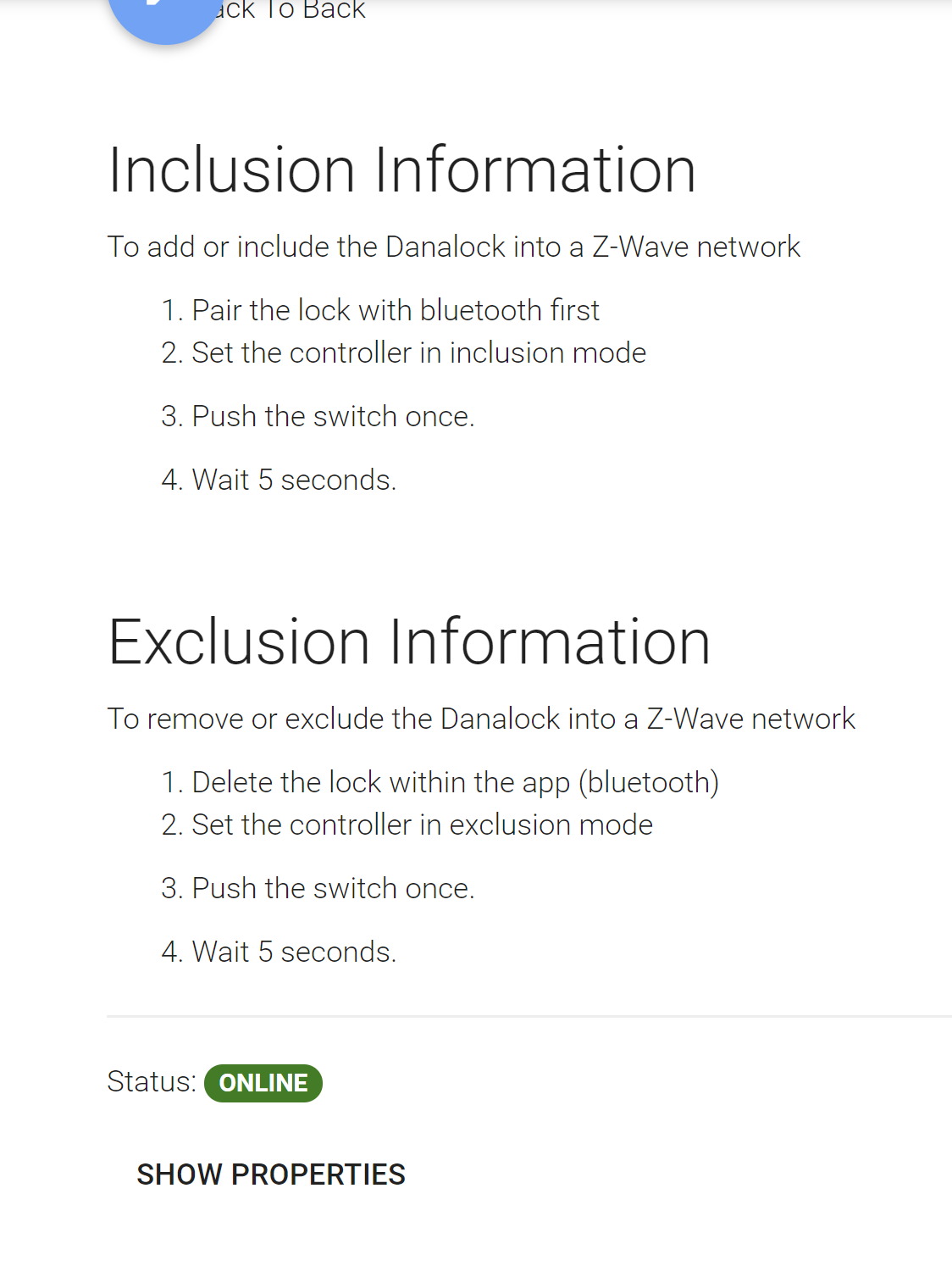

I tried inclusion many times with z-stick unplugged, but every time the lock was included non-securely. After some googling and reading, I deleted lock thing, excluded it from controller, removed the lock in danalock app, did reset procedure as described here: https://doc.eedomus.com/files/Danalock_V3_Product_manual_Z_Wave_V_0.9.1.pdf
Important thing I learned from this doc is to do it while z-wave primary controller is missing or otherwise inoperable.
Then add added lock to the danalock app and once again did inclusion process but with z-stick plugged in and by triggering discovery process from paper UI.
As it took me more than one try, I thought maybe someone will find this info useful

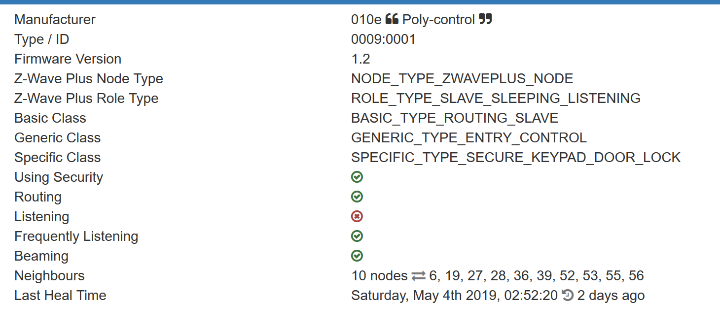

Where do I get the information from your screenshot below?
I checked my xml file in the openhab zwave directory and found:
<security>false</security>
I assume that means it’s not included securely!?

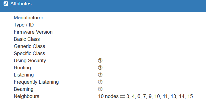

Got it! Habmin in “Attributes”
My controller does not show any security :frowning:
In PaperUI Security is set correctly - I assume:
Or should I use
All Devices?
