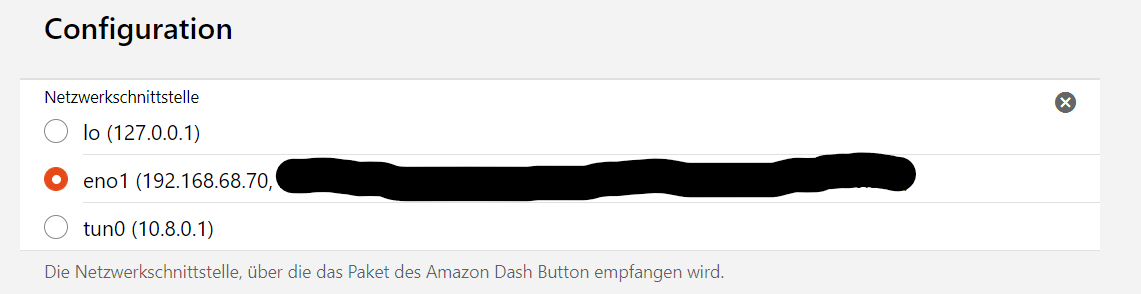

Just a quick final update about this topic.
Because I had network issues after changing the device name to eth0
(see here: Network connection issues (http binding) - Setup, Configuration and Use / Beginners - openHAB Community), I thought I try to switch this back to see if it’s related (or a coincidence with my network provider problems.
It turned out, that the configuration of the dash button changed.
Previously the interface name needed to be specified in regular text.
Now there is a selection available - and voilá - even with eno1 it works like a charm after setting it correctly:
