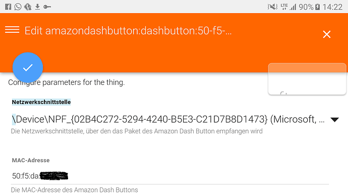

@binderth You can try to add dash button manually in PaperUI. Then you can see, if your network interface is available. Please check here:
Maybe the line “Network Interface” is empty or has no pull down list…
Is one or more are available, try them, and fill in MAC address manually.

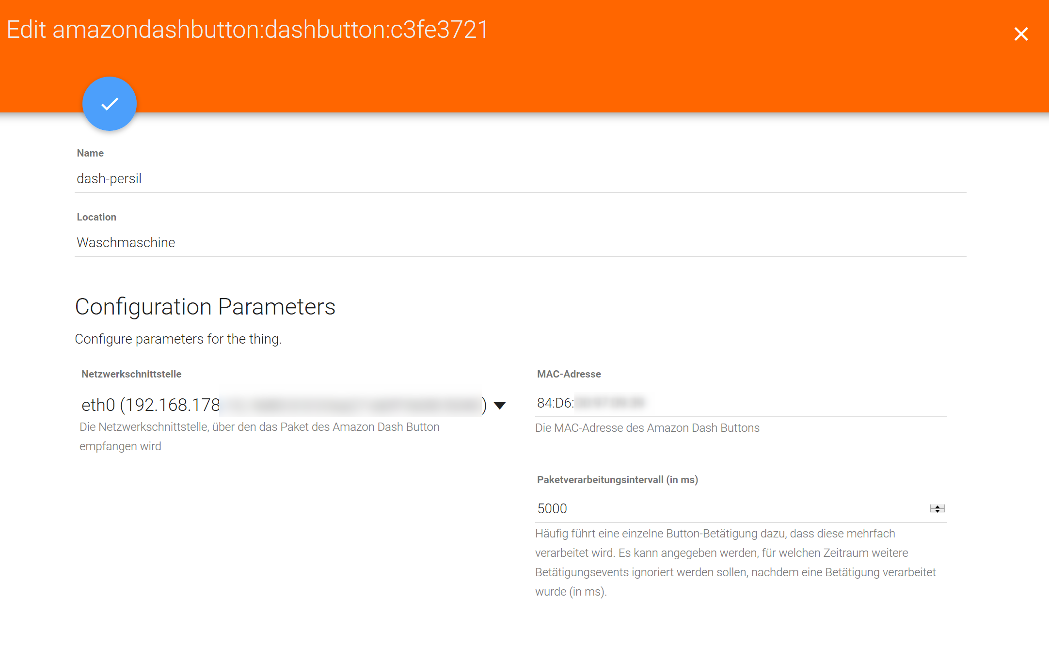

that’s strange: yesterday it wasn’t possible to add a Thing manually (under the orange Header everything was blank), today I got this:
unfortunately its Status is offline and theres no capture in the rule:
rule "Dash button WaMa pressed"
        Channel "amazondashbutton:dashbutton:c3fe3721:press" triggered
		logInfo("WaMa Button", "WaMa button wurde gedrückt")
Mustn’t there be some Kind of Connection between pcap4j and OH2? How does OH2 scan the network if I doesn’t provide it with some path to the executable? or is this ootb? :wink:

2nd:
And while adding a new Dash Button manually, give ThingID the same like your MAC address:
and then change your rule, too:
Channel "amazondashbutton:dashbutton:84-d6-f7-d5-be-be:press" triggered
