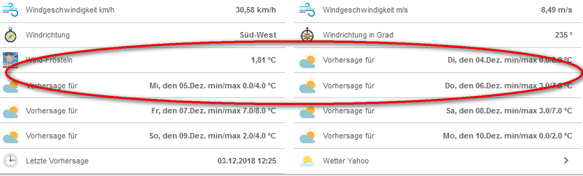

Hi @vzorglub, thx for reply.
I’m using the new OpenWeatherMap-Binding, which gives me information about current temperature, pressure, etc. and forecast-info for those values in 3-hour-steps up to 5 days.
I want to achieve to adress the several forecast-values to a fixed day (current, day1, day2…day5). The problem is that forecast-period slides every 3 hours. The current time comes from the item localLastMeasurement of my owm.items-file.
Eg. at 22:20/10:20 pm the 3-hour-forecast(01:00/01:am) belongs to “day1” and of course the next 7 forcasts too. But at 00:20 all those forcasts are belonging to the “current” day and the next 8 to “day1” etc.
In detai i want to achieve:
- declaring the variables
current, day1, day2...day5 in the rule, beginning from localLastMeasurement which should be transformed in a value like “yymmdd” or “yy-mm-dd” or “a, yy-mm-dd” (a = day-name), and of course corresponding variable for summarizing temp, hum, etc for the corresponding day (eg. day1_temp_sum)
- defining the loops (while, if, etc). First i’m using a While-Loop where i get the several items from the virtual item corresponding with it, beginning with the TimeStamp, then Temperature, Humidity, etc. The Solution to do so, i found here from @5iver and also post from @rlkoshak.
Next I will compare the Timestamp item (transormed in the same way as above) with the variable “day1…5” and then adding the virtual Temp-Item to variable “day1…5_temp_sum”.
- At the very end i want to calculate an average for daily temp, hum, etc., or min/max. The result can look like this (from my "normal weather-binding with yahoo-provider)

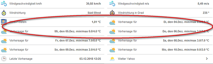

2018-12-03 11:52:55.812 [INFO ] [rthome.model.script.owm.owmSummarize] - Count: 2 Summe: 23.50 itemindex: 9
2018-12-03 11:52:55.842 [INFO ] [rthome.model.script.owm.owmSummarize] - Timestamp-Item: localHourlyForecast9Timestamp (Type=DateTimeItem, State=2018-12-03T19:00:00.000+0100, Label=Timestamp in 09 hours, Category=time, Groups=[gOWM]) :Temperature-Item: localHourlyForecast9Temperature (Type=NumberItem, State=10.71, Label=Temperature in 09 hours, Category=temperature, Groups=[gOWM])
2018-12-03 11:52:55.866 [INFO ] [rthome.model.script.owm.owmSummarize] - Count: 3 Summe: 34.21 itemindex: 12
2018-12-03 11:52:55.893 [INFO ] [rthome.model.script.owm.owmSummarize] - Ende: 12 :Schrittweite: 3 Temp-AVG: 11.40333333
2018-12-03 12:12:00.570 [INFO ] [.smarthome.model.script.sonoff.rules] - Tasmota Rel.Vers. set to Items:
2018-12-03 12:22:56.652 [INFO ] [rthome.model.script.owm.owmSummarize] - Current-Time-Item: 20181203
2018-12-03 12:22:56.678 [INFO ] [rthome.model.script.owm.owmSummarize] - Timestamp-Item: localHourlyForecast3Timestamp (Type=DateTimeItem, State=2018-12-03T13:00:00.000+0100, Label=Timestamp in 03 hours, Category=time, Groups=[gOWM]) :Temperature-Item: localHourlyForecast3Temperature (Type=NumberItem, State=12.34, Label=Temperature in 03 hours, Category=temperature, Groups=[gOWM])
2018-12-03 12:22:56.697 [INFO ] [rthome.model.script.owm.owmSummarize] - Count: 1 Summe: 12.34 itemindex: 6
2018-12-03 12:22:56.720 [INFO ] [rthome.model.script.owm.owmSummarize] - Timestamp-Item: localHourlyForecast6Timestamp (Type=DateTimeItem, State=2018-12-03T16:00:00.000+0100, Label=Timestamp in 06 hours, Category=time, Groups=[gOWM]) :Temperature-Item: localHourlyForecast6Temperature (Type=NumberItem, State=11.16, Label=Temperature in 06 hours, Category=temperature, Groups=[gOWM])
2018-12-03 12:22:56.737 [INFO ] [rthome.model.script.owm.owmSummarize] - Count: 2 Summe: 23.50 itemindex: 9
2018-12-03 12:22:56.757 [INFO ] [rthome.model.script.owm.owmSummarize] - Timestamp-Item: localHourlyForecast9Timestamp (Type=DateTimeItem, State=2018-12-03T19:00:00.000+0100, Label=Timestamp in 09 hours, Category=time, Groups=[gOWM]) :Temperature-Item: localHourlyForecast9Temperature (Type=NumberItem, State=10.71, Label=Temperature in 09 hours, Category=temperature, Groups=[gOWM])
2018-12-03 12:22:56.772 [INFO ] [rthome.model.script.owm.owmSummarize] - Count: 3 Summe: 34.21 itemindex: 12
2018-12-03 12:22:56.790 [INFO ] [rthome.model.script.owm.owmSummarize] - Ende: 12 :Schrittweite: 3 Temp-AVG: 11.40333333
2018-12-03 12:24:36.871 [INFO ] [marthome.model.script.astro-rules_99] - Moondistance updated every 5 Minutes by "astro.things " 2018-12-03T12:24:36.718+0100 / 1 Log only once an hour
2018-12-03 12:25:04.733 [INFO ] [smarthome.model.script.weather-rules] - Forecast executed every 30 min. / 1 log only once an hour
2018-12-03 12:52:58.714 [INFO ] [rthome.model.script.owm.owmSummarize] - Current-Time-Item: 20181203
2018-12-03 12:52:58.737 [INFO ] [rthome.model.script.owm.owmSummarize] - Timestamp-Item: localHourlyForecast3Timestamp (Type=DateTimeItem, State=2018-12-03T13:00:00.000+0100, Label=Timestamp in 03 hours, Category=time, Groups=[gOWM]) :Temperature-Item: localHourlyForecast3Temperature (Type=NumberItem, State=12.35, Label=Temperature in 03 hours, Category=temperature, Groups=[gOWM])
2018-12-03 12:52:58.755 [INFO ] [rthome.model.script.owm.owmSummarize] - Count: 1 Summe: 12.35 itemindex: 6
2018-12-03 12:52:58.780 [INFO ] [rthome.model.script.owm.owmSummarize] - Timestamp-Item: localHourlyForecast6Timestamp (Type=DateTimeItem, State=2018-12-03T16:00:00.000+0100, Label=Timestamp in 06 hours, Category=time, Groups=[gOWM]) :Temperature-Item: localHourlyForecast6Temperature (Type=NumberItem, State=11.17, Label=Temperature in 06 hours, Category=temperature, Groups=[gOWM])
2018-12-03 12:52:58.799 [INFO ] [rthome.model.script.owm.owmSummarize] - Count: 2 Summe: 23.52 itemindex: 9
2018-12-03 12:52:58.821 [INFO ] [rthome.model.script.owm.owmSummarize] - Timestamp-Item: localHourlyForecast9Timestamp (Type=DateTimeItem, State=2018-12-03T19:00:00.000+0100, Label=Timestamp in 09 hours, Category=time, Groups=[gOWM]) :Temperature-Item: localHourlyForecast9Temperature (Type=NumberItem, State=10.72, Label=Temperature in 09 hours, Category=temperature, Groups=[gOWM])
2018-12-03 12:52:58.864 [INFO ] [rthome.model.script.owm.owmSummarize] - Count: 3 Summe: 34.24 itemindex: 12
2018-12-03 12:52:58.895 [INFO ] [rthome.model.script.owm.owmSummarize] - Ende: 12 :Schrittweite: 3 Temp-AVG: 11.41333333
I get a sum and an average. So the Torso-Rule seems to work.
I hope you can understand what i have trying to explain in my simple, amateurishly words. Please be mercifully with me.
Thx
