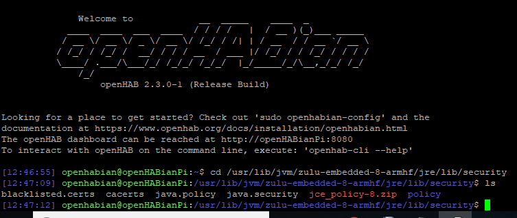

I have managed to download the jce_policy-8.zip file too the location
/usr/lib/jvm/zulu-embedded-8-armhf/jre/lib/security
it is stored there but i’m struggling to unzip the file
i have tried too unzip the file using commands found on google but getting error “Something like it cant find the file period”
How do i unzip the file ? or do you know of another place too download the java files directly without being zipped ?
@Sharpy I tried on my RPI to unzip that file and had issues as well. I didn’t fight it long before using FileZilla to move the jar files into OH. If you go this route you’ll need to change the file permissions then change back after the transfer.

I unzipped it on my PC and moved it trough the openHAb config folders to the right folder

I have unzipped the file on pc and copied them through smb too openhabian share folder and moved the files from there using
sudo mv local_policy.jar /usr/lib/jvm/zulu-embedded-8-armhf/jre/lib/security/
sudo mv US_export_policy.jar /usr/lib/jvm/zulu-embedded-8-armhf/jre/lib/security/
