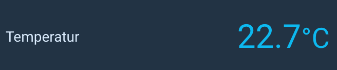

Why is there an option to choose the font size for displaying the item value when the unit font size (and also the widget name) does not scale equally but is always smaller than the item value itself?
This looks odd to me:
And I found also no satisfying answer why there is no font size option for the widget name when there is one for the item value???
Looking at my example picture explains that this looks funny. Defining the icon size (which is possible) may also mess up the presentation. If you are not cautious a big icon causes also scaling issues. So why is it forbidden for the widget name?

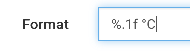

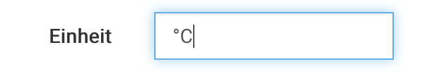

I digged through the OpemHAB community and found this topic:
where the unit is simply moved from the Unit (in my german case it is “Einheit”) field:
to the Format field (and of cause removing the entry in the Unit field :wink:) :
Having the unit “°C” in the format field displays it in the same font size like the item value!!!
Problem solved!!!
