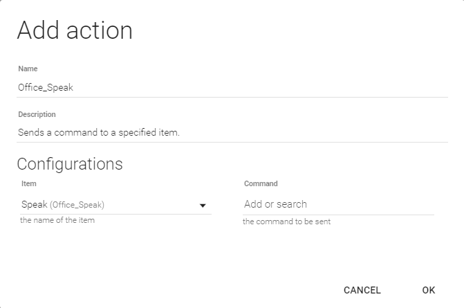

I have setup everything and can get alexa to speak a command written in the “command” field of the rules section in Update action.
However I cannot find in the documentation what to put in the command field to speak out the variable text from an item. The item is called “Alexa_Speak_Office_Var” and is updated via node red.

Thanks for the reply.
I got confused about the “echo” text, thought it was used for executing to command line :thinking: as my item is called “Office_Speak” without the echo bit.
I have been playing around and got it working now.
I was going about it all wrong, assuming I had to convert a variable string into text from within a rule in OH when all I needed to do was send a string msg.payload to Office_Speak (speak item linked to the echo) in node red and it reads it out no problem.
