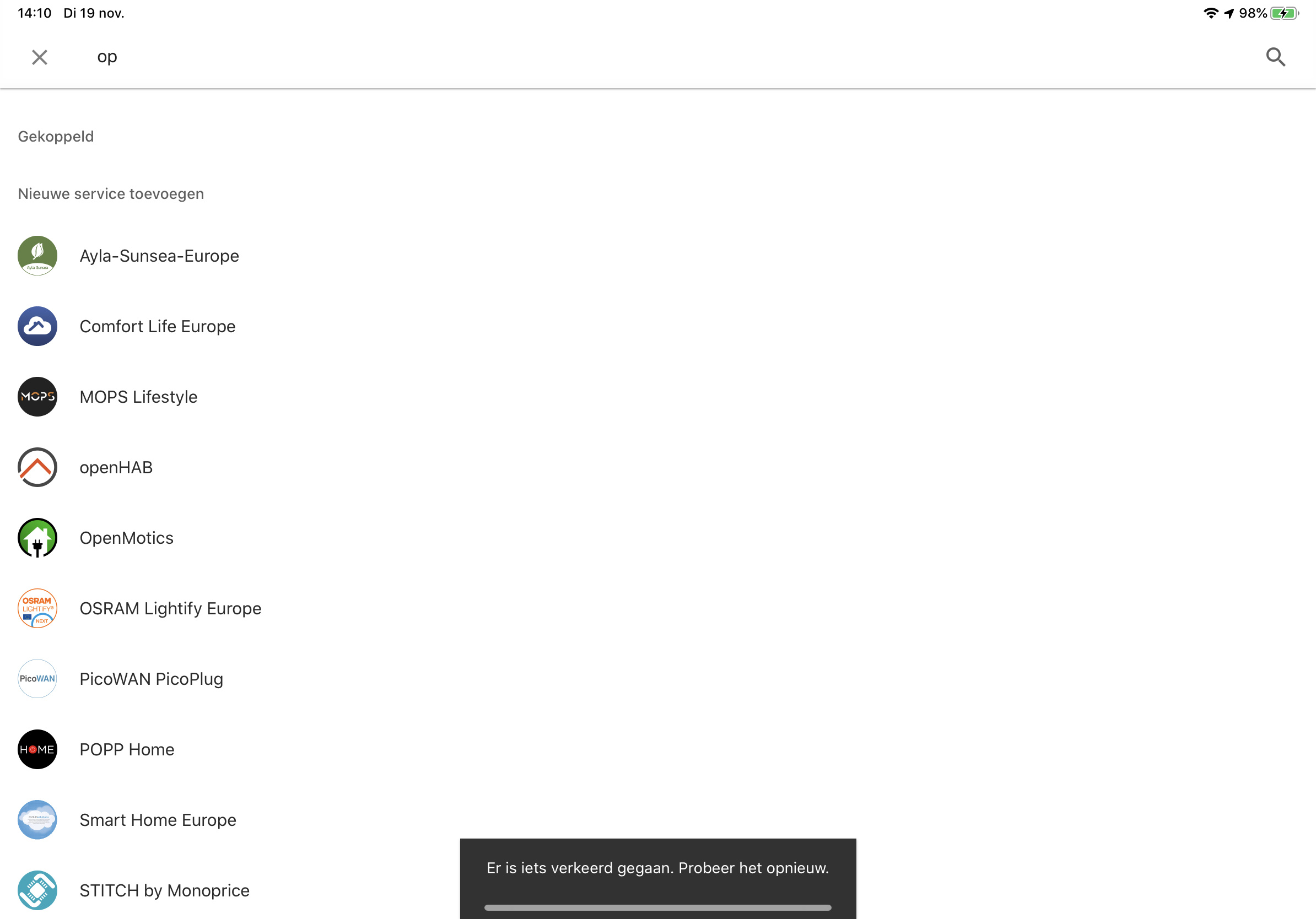

my config was working perfectly
i added a new device which i needed to sync with google assistant but it gave me a verbal error
i decided to remove openhab and add openhab again(to get all the devices which i tagged again)
problem is i can not get it to work anymore.
cloud connector is online (can acces openhab cloud on my pc)
openhab app is working on ios(can acces everything both remote and local)
the thing is when i try to add openhab in google assistant i normally get the oath2 screen, well not anymore
it instantly says Openhab is connected and after a while it states "something went wrong, please try again.
i tried removing all the tags from openhab to see if that causes problems but the problem stays the same.
emptied cache safari on my iphone, still the same problem.
how can i force google assistant to bring up the oath2 screen from openhab?

Ha i put my iphone in flight mode. it does exactly the same so it looks like the problem is in google home/assistant and the Openhab plugin which is supplied to google. either google changed something or Openhab did.
i noticed dome openhab changes 2 months ago and i think these are responsible
it is not even actively looking to openhab(how can he do this without a network connection)
i tried something else.
since openhab is not the problem if figured it must be google
If i login with another google gmail account everything works perfectly
so how can it be that one account fails and another works
can google disable things on an account level or is the problem with myopenhab which blocks my google accont so it does not get forwared to the oauth2 screen

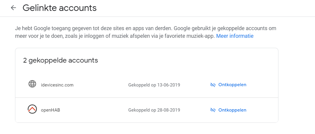

Ha UPDATE.
IT IS WORKING AGAIN
i was searching for the page to delete my account. scrolled to the bottom
i noticed an entry LINKED ACCOUNTS
opened it and instantly noticed openhab
deleted it and the problem is gone.
so the problem is not giving google access to apps but it seems Google was linked to openhab
so this at the bottom of the security page called LINKED ACCOUNTS
again thanks for your help.
i had revoked google access to everything but this sneaky menuy was hidden in plain site

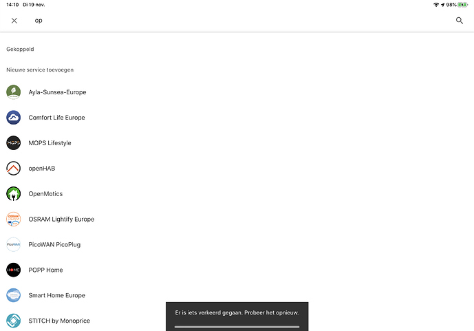

I was too early. I could remove the Google account from myOpenHAB and the OpenHAB from my Linked accounts in Google. But I cannot get the Google Assistant working anymore. I always get two screens. The first says OpenHab is linked and the second one is there was an error “Something went wrong. Try again.”.
When I look into Google the OpenHAB account is linked again and in myOpenHAB the Google Assistant is linked as well.
So what can I do to start debugging this or has anyone had the same experience?

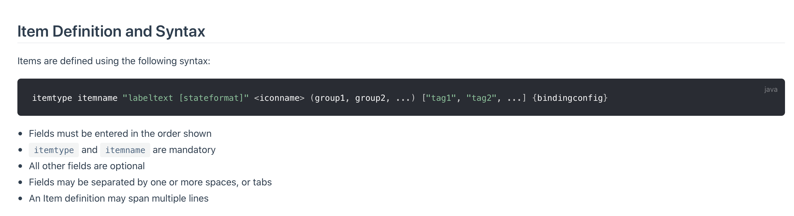

I just had the same problem. Although this topic is marked “SOLVED”, it doesn’t seem to have a replicable solution (more coincidence or luck). So please find here my fifty cents:
I made an observation with the openhab integration of google assistant. It seems to be “picky” regarding the consistency of the “.items” files.
A single items file with the following content works …
Dimmer LoungeWestTable_LightDimmer "Lounge Table Lights" {ga="Light"}
Dimmer LoungeEastWall_LightDimmer "Lounge Wall Lights" {ga="Light"}
… but not the following one
Dimmer LoungeEastWall_LightDimmer {ga="Light"}
The missing “Lounge Wall Lights” leads to crash the google assistant update process.
Your second item does not have an label. I believe a label is mandatory! It doesnt make sense without.
Not according the documentation.
Hmm.. Odd, I dont see how Google is suppose to know what to call each devices then..
But anyway, all my items are equal.. They should behave the same, but dont :slight_smile:
