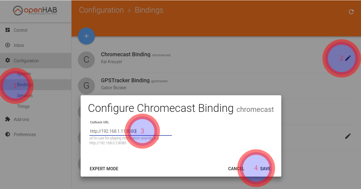

You can probably get it working by setting the IP of the machine running openHAB in the Chromecast Binding callback URL.
I wish, but not:

Is the Chromecast allowed to connect to that IP and port? Cause that is how the TTS with a Chromecast works. openHAB will serve the audio file using the webserver and openHAB instructs the Chromecast to download it from that IP/port. Firewall rules and username/password authentication may be blocking it.
Yes, I think so. I’ve tried with other program to send the audio to the chromecast: chromecast-audio-stream and works.
But maybe I need to do something with OpenHab?
can you use another host on your LAN to access that URL? (http://192.168.0.15:8080)
for example: your mobile phone
maybe? your firewall on Windows is blocking access to the openHAB2 web service
check also:
bundle:list -s |grep chrome
:open_mouth:
Thats it! Thank you both!
I love you :blush: I was so frustrated with this. I deactivated the firewall and now is working. Now I have to add in some way this rule exception.
de nada :slight_smile:
(mark Wouter’s post as the one with the solution plz to close this thread)
