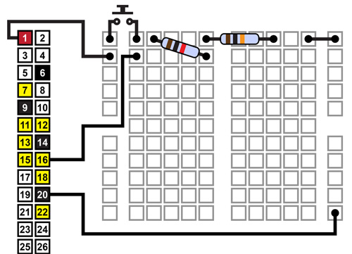

Hello BillGOH. I want to realize the same function with the ES-GAS-2 sensor. Can you post a schema how you connected the sensor to the GPIO pins of the RPI.
Thank you, Michael.
my electrician did all the work. He made me a connection between the ES-GAS-2 sensor and the GPIO pins. As an example we used this:
