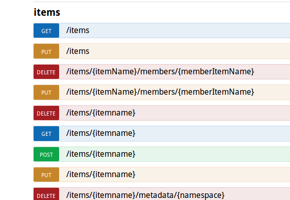

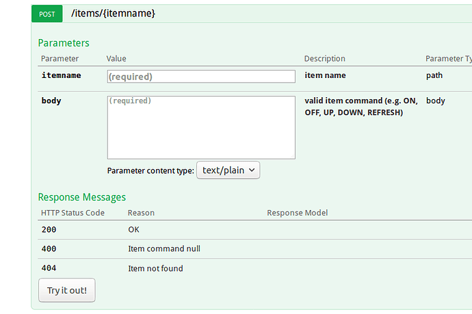

REST API
Go to Items
Select POST
Enter the item name
Enter the value
Click “Try it out”
I do not have the rest api, only the home builder :persevere:, anyway I am testing with the setpoint of the temperature of the heating and nothing

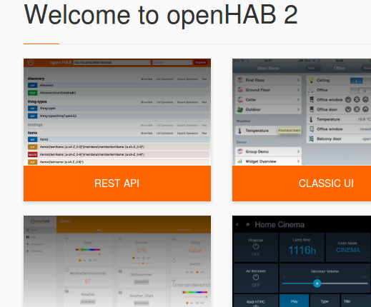

Hi Vincent,
a side question: How do you display the rest api in the main landing page?
Kurt
I run expert mode, maybe that’s why I have the REST api in the landing page.
Are you on simple, or standard mode?
mmh. I’m not really sure to be honest. I wasn’t aware about the expert mode :zipper_mouth_face:
standard (openhabian), I guess.
Kurt
In your conf/services folder there is a file called addons.cfg
It looks like this:
# The installation package of this openHAB instance
# Note: This is only regarded at the VERY FIRST START of openHAB
# Note: If you want to specify your add-ons yourself through entries below, set the package to "minimal"
# as otherwise your definition might be in conflict with what the installation package defines.
# Optional. If not set, the dashboard (https://<yourserver>:8080/) will ask you to choose a package.
# Valid options:
#   - minimal  : Installation only with dashboard, but no UIs or other add-ons. Use this for custom setups.
#   - simple   : Setup for using openHAB purely through UIs - you need to expect MANY constraints in functionality!
#   - standard : Default setup for normal users, best for textual setup
#   - expert   : Setup for expert users, especially for people migrating from openHAB 1.x
#   - demo     : A demo setup which includes UIs, a few bindings, config files etc.
# See http://docs.openhab.org/configuration/packages.html for a detailed explanation of these packages.
#package = minimal
Uncomment the #package=minimal and change it to package=standard
Restart OH
