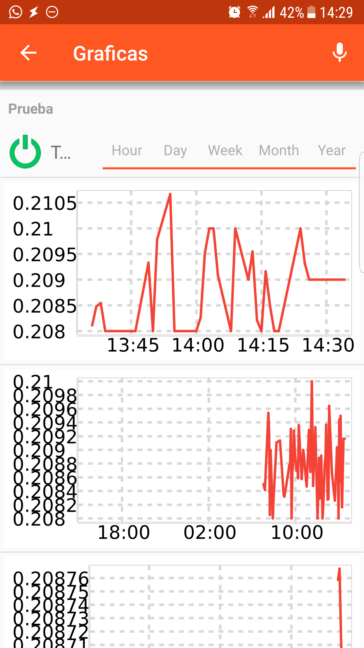

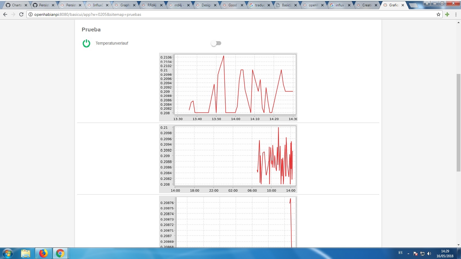

One last question, I have a visual problem with the time periods of the graphics.
1- In the app I get all the graphics followed one below the other and although press the buttons (hour, week …) nothing happens since they are displayed all at the same time.
2- If I access by browser, all the graphics also appear one below the other but the time buttons do not appear
I think you’ve got some errors with the mapping of the Switch in your sitemap
You shouldn’t see the switch visible on your browser screenshot.
What do you mean exactly? In the browser, you’d need to reload the page
The above code should give you sth like this, else you’re not persisting a group:

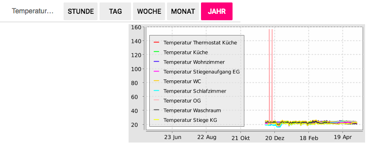

BTW, if someone reads this who can answer: Is there a way to clear the wrong data entry out of the RRD4J DB? (on 20th december one of my sensors recorded a temperature of 9999 °C, making the graph unreadable).

Ok, the problem was that he had not defined the item, IntervallTempus :sweat:
Now, i have one graph, but to see another period of time I must press the button and refresh the page to change the graph, is it normal?

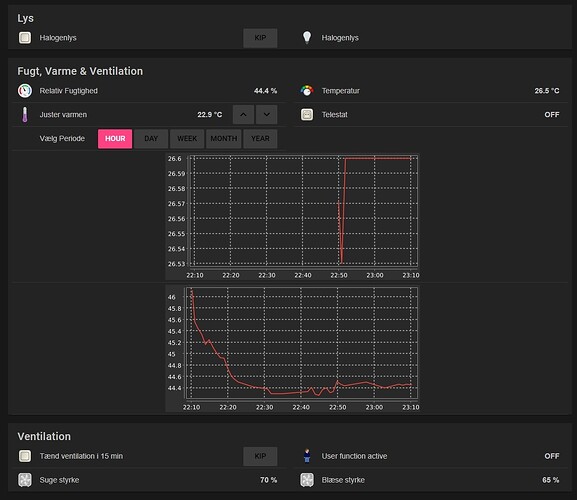

This is a screendump from BasicUI
I wonder why rrd4j persists 2 decimals. I have even seen charts with 3 decimals. Any idea why? I just want 1 decimal, and thats it. I have set up once decimal in my items as well. But rrd4j seem to live on its own.
Also please note the temeprature readings in oppe right place on the screendump saying 26.5 degrees. Yet rrd4j persist 26.6.
Any ideas why?
