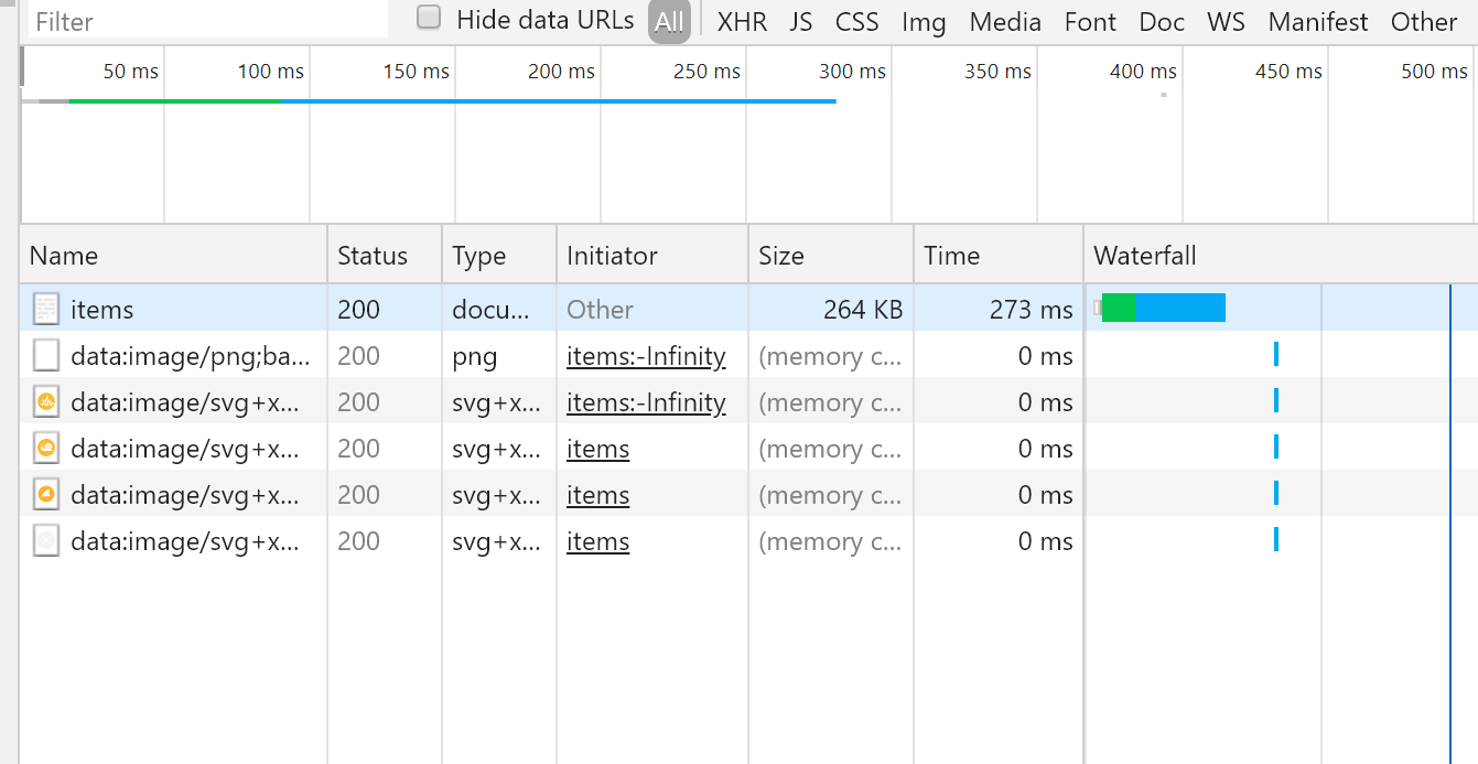

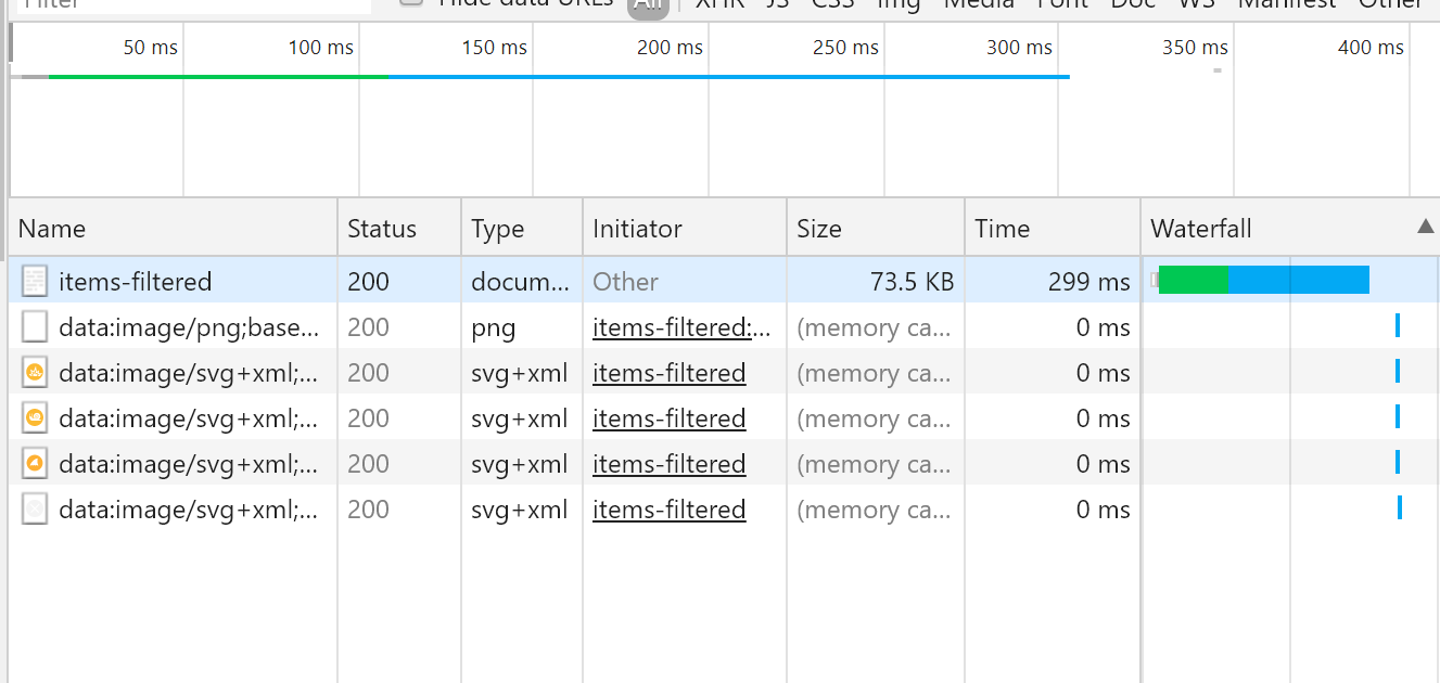

I moved all the items into the group and got it working with the plugin. Can’t yet say if it’s better on the tablets - will get a feel for that over the next few days. However, this is pretty telling -
Default Items
Filtered Items
Generation of the items is a bit slower but the size of the data shows how much noise is removed. 72% less. That has to make a difference on low-end tablets which run the browser 24/7.
