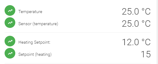

Sorry my msitake. It does not. But in PaperUI I can see that the UI does not pickup the correct type for setpoints (QuantityType) either. For temperature everything looks fine. Check this screenshot:
As you can see, both mapped and defined items for temperature are shown correctly in PaperUI for the temperature channel:

But for the setpoint channel (the second one), only the defined one in the items file seems to be displayed correctly. The mapped item from the channel definition did not pick up the correct type, so it is shown without any units, although in the channel definition the QunatityType has been set:

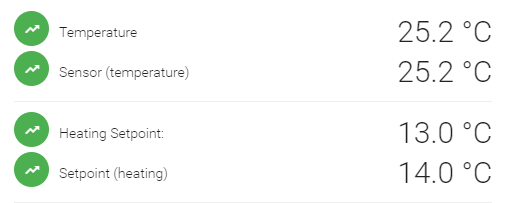

for the display issue in PaperUI this has been solved by modifiying the channels.xml and rebuilding the binding like this:

so now it is showing correctly as it should:

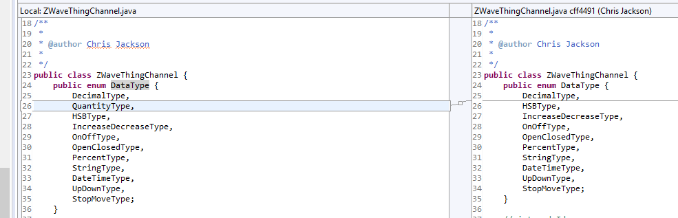

I guess I found something in the code why the issue occurring. I am building it at the moment to see if it works.

@chris: I believe it is solved now with this simple change
cheers

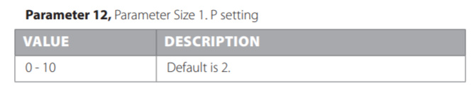

Two of my thermostats are mounted as Power regulators (1-10 setting ON/OFF duty), mounted in another room.
The z-trm2 also supports this mode, but only as parameter 12 (even though doc states it does not)
Since I’m planning on monitoring the temperature using Aeon multisensor6 in the actual rooms I will need to set this parameter from a rule.
@chris Is it possible to make parameter 12 available via a channel, or is it possible to send new parameter values from a rule?
Yes, I will add this.

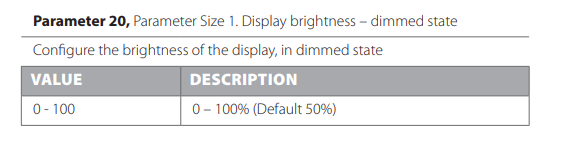

While you’re at it:
Will make it possible to turn off display in bedroom at night :slight_smile:
Done…
