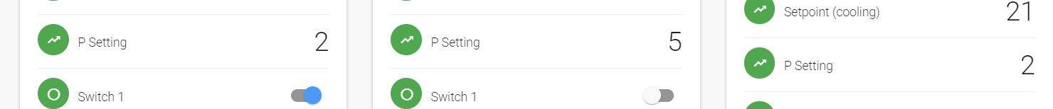

The P setting for P mode, param12, made a channel by Chris resently in the development version of the z-wave binding, makes the z-trm2 work just as a power-regulator with settings 0-10, where 0 is always off, and 10 always on, and the rest is on/off dutycycles. 5 is 50%on 50%off.
One of my z-trm2 is placed in another room than the actual floor-heating I’m controlling, and I have also put a Multisensor 6 in the actual room and are planning on setting the P setting using a rule reading the Multisensor 6 temperature. I have not started on that rule yet, but it should be quite simple using the expire binding and check the temperature every 2-3 hrs or so.
Now the reason I want to use the P mode instead of direct on/off control, is that if OH goes down for some reason, the floor heating will not be stuck on ON, as that will turn my basement into a sauna :slight_smile:

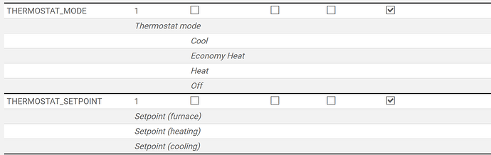

Just installed a few Heatit z-trm2. Using snapshot, 2.4.0.
I am not able to adjust the ECO Setpoint. Heat and Cool setpoint works. Others with the same?, or is it a firmware, binding issue?

I don’t think that is made a channel.
You can set it in Device Configuration, and turn it on/off via the Thermostat mode channel.
If you really want to control this, @chris can make it a channel in the binding.
He did that for Psetting param12.

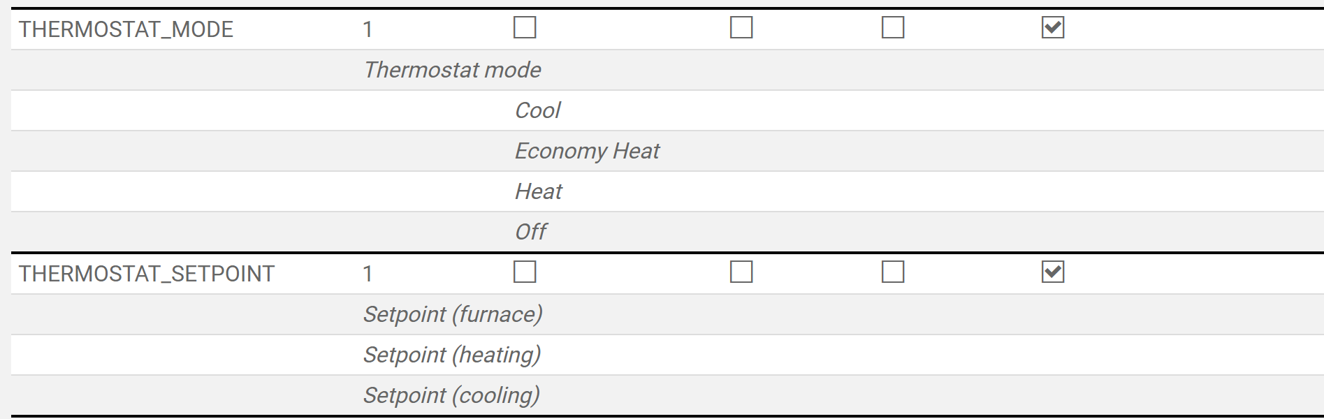

Hum, I thought the "channel = “zwave:device:bbc11ae4:node9:thermostat_setpoint_furnace”
was for setting the ECO - setpoint.
The, channel = “zwave:device:bbc11ae4:node9:thermostat_setpoint_heating” } and channel = “zwave:device:bbc11ae4:node9:thermostat_setpoint_cooling” is working as expected.
Any ideas that the Furnance is used for?
No.
The z-trm2 Doc says that Cooling is not supported.
I just unlink the Furnace and Cooling setpoints and forget about them.
The strange thing is that setpoints for cooling is actually working. If you set any temperature there, and changes the Mode to Cooling, the Setvalue is shown in the display. - I know Cooling is described in the manual “Not Implemented”, but it will be in a later firmware. It seams to work today. It turns on the Relay to power a cooler if that is installed instead of “heating”.
ECO-mode is supported on the device itself,. For me it looks like the “:thermostat_setpoint_furnace” " is here for the eco-setpoint, and something is not working while posting to this channel, or wrong labels?
I can “rule” this “eco-mode” away if I don’t want to use the eco mode. But I want to use it to build logic around then a user (wife) manualy choose the eco-mode on the device and sets a new eco-temperature there.

Cooling Setpoint aka param13 is not the same as param11 the Powersaving ECO setpoint.
Not sure that you say here, or responds to - but agree that param 11 and 13 is not the same and changes two different things.
Trying to understand it, I thought that params is “mapped” to channels in the z-wave database. Is there a way to change or update this Endpoint - furnance to Economy ?
 <channel id="thermostat_setpoint_furnace" typeId="thermostat_setpoint">
        <label>Setpoint (furnace)</label>
        <properties>
          <property name="binding:*:DecimalType">THERMOSTAT_SETPOINT;type=FURNACE</property>
        </properties>
      </channel>
@chris will have to compile that into the binding, just as he did for parm12, Psetting.
I would suggest removing the Furnace & Cooling setpoints and introduce an ECO setpoint->param11
Yes, and the display brightness Chris forgot the last time around :slight_smile: X
