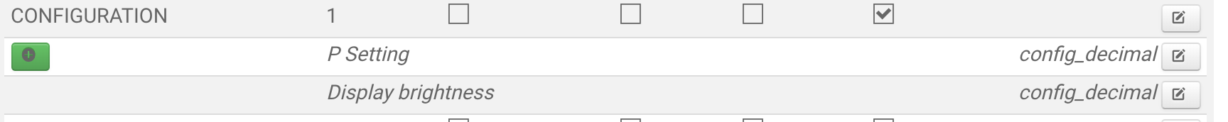

This P setting is confusing me. I have the HeatIt v1.8, but cannot find how to change the P setting (when using the P sensor).
It seems to me that this is only added to the later v2.6, but as this is quite basic functionality I find it hard to believe.
Right now the only way I can manage to change it through OpenHAB is through the configuration parameters in HABmin. But it seems that this is not updated if I manually change it on the thermostat itself.
So my question to this forum - is it true that P setting can’t be changed in v1.8? And if so, is it possible to tweak it to get it done?
I snooped in the config-file of the v2.6, I observed the following under channels - is it possible to manually add this in my current config-file for my version?
The only difference I saw in the config-section was that the parameter name was “config_12_1” in the new version, as opposed to “config_12_2” in my current. Also, there is added a description-element.
