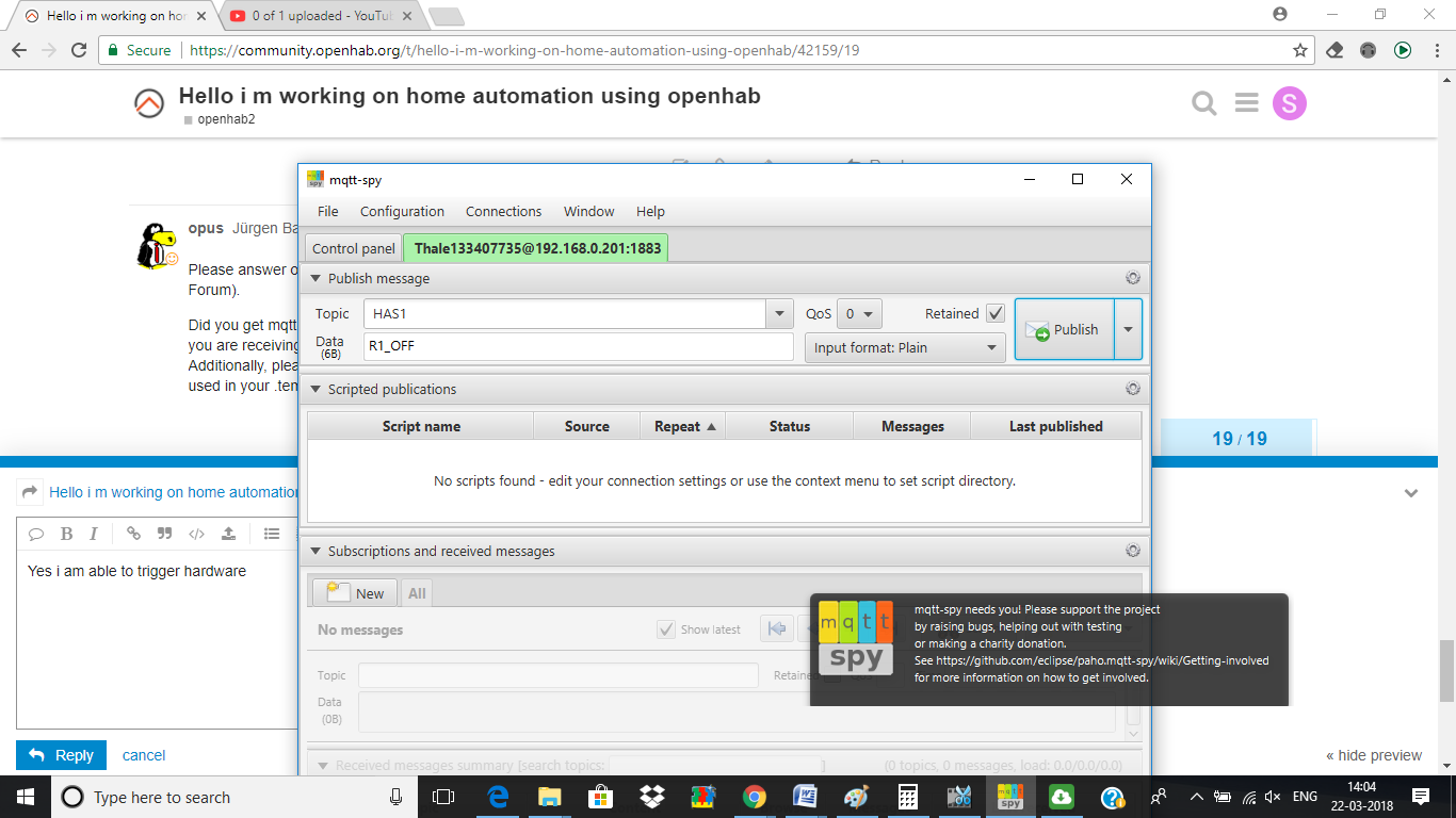

How do i use mqtt-spy to check as per your suggestion i m using win 10 laptop pls help

I did download the mqtt-spy .jar file, dobleclicked on the file and it started (on Windows 10).
In mqtt-spy connect to your broker with your credential and subscribe to Messages (“#” for all topics).

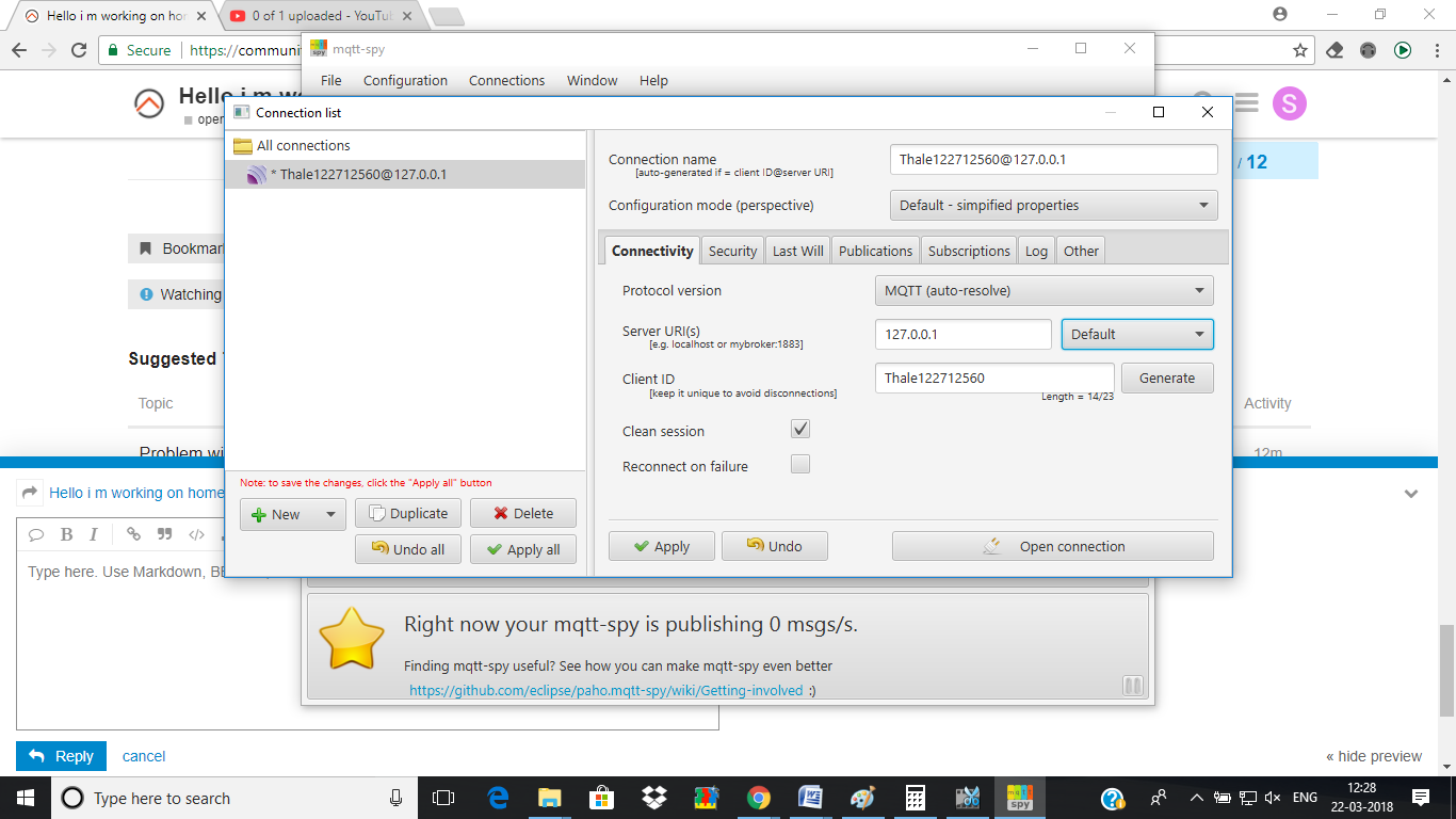

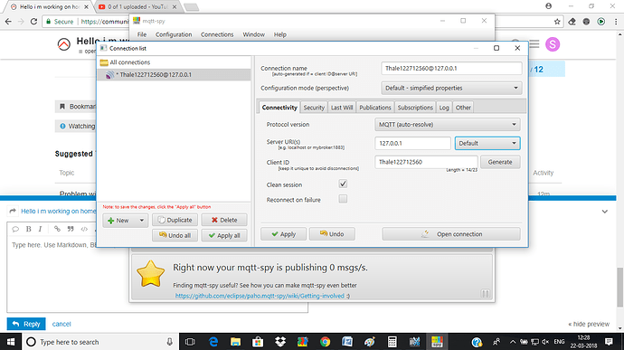

Could you explain what and where broker ( raspberry pi details to be filed ) and also other relevant…details so i can check pls explain me with the help of example pls thanks
I’m not at my system now, so I can only give hints oui of my memory.
You are using mqtt-spy to connect to your broker from another system, in order to connect you need the IP of the system where the broker runs and the credentials (username and Password, the same you have in your mqtt.cfg). Using those inputs mqtt-spy should be able to make the Connection (shown with a green tab).
Server url ------------------- IP address of raspberry broker :1883
What is Client ID just below the server url ???
Adove that connection name ???
Configuration mode ???
Pls help
Pls help

Mqtt-spy ----------------- Server URL as given IP address of Raspberry pi i m able to trigger the hardware …

Did you get mqtt-spy to connect to your mqrtt-broker?? If so, please try to sent a mqtt via OH and post what you are receiving in mqtt-spy.
Additionally, please post the message you are receiving in mqtt-spy (using that, we could verify the Syntax used in your .tems file)
Yes i am able to trigger hardware …
But not able to trigger thru OH2
