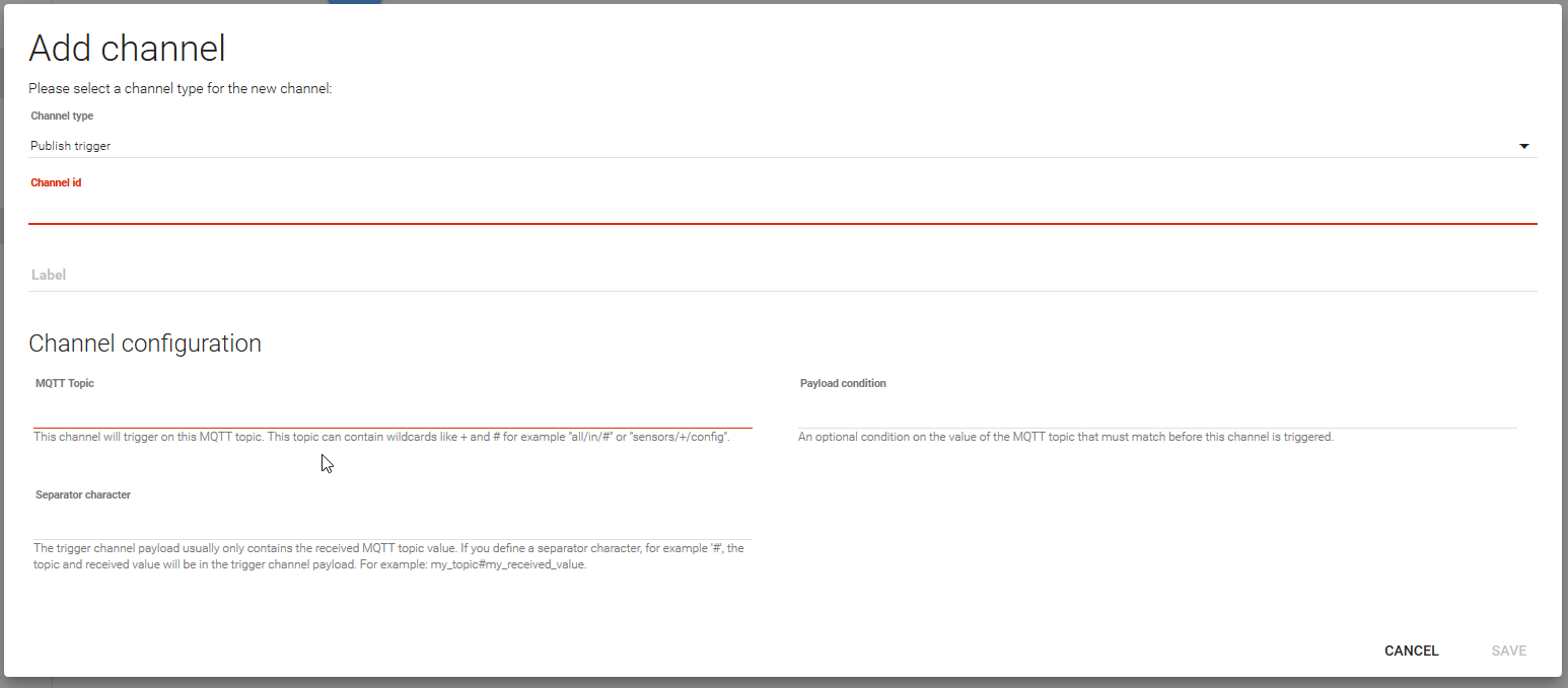

You have picked the wrong Thing to add channels too :slight_smile: The new MQTT binding is actually two folded. You add a broker first. You can add Trigger channels to this broker (as documented). And then, as seen in the blog post, you add a Generic Mqtt Thing on which you can add different types of channels.
Everything is also possible via text files if wanted.
Every channel on openHAB has a unique ID. This has nothing to do with MQTT actually and it is a bit sad, that Paper UI is highlighting this field and not prefiling it with a randomly generated id like it does on auto-discovery etc.
