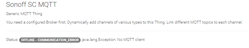

So, i upgraded to 2.4 (upgrade not a fresh installation).
I have windows 10 with latest update and running a local mosquitto server.
After upgrade, if i change anything in the .things files, it just loses communication and same error appear, and i have to restart OH many times until all Things come to live.
Sample of the config is as below:
Bridge mqtt:broker:bonnnuc "Bonn Mqtt Broker" [ host="192.168.0.20", secure=false ]
    Thing mqtt:topic:sonoff_sc_topics "Sonoff SC MQTT" {
        Channels:
            Type number : sonoff_sc_temp    "Sonoff SC Temp"     [stateTopic="tele/sonoff/SENSOR", transformationPattern="JSONPATH:$.SonoffSC.Temperature"]
            Type number : sonoff_sc_humid   "Sonoff SC Humid"    [stateTopic="tele/sonoff/SENSOR", transformationPattern="JSONPATH:$.SonoffSC.Humidity"]
            Type number : sonoff_sc_noise   "Sonoff SC Noise"    [stateTopic="tele/sonoff/SENSOR", transformationPattern="JSONPATH:$.SonoffSC.Noise"]
            Type number : sonoff_sc_air     "Sonoff SC Air"      [stateTopic="tele/sonoff/SENSOR", transformationPattern="JSONPATH:$.SonoffSC.AirQuality"]
            Type number : sonoff_sc_light   "Sonoff SC Light"    [stateTopic="tele/sonoff/SENSOR", transformationPattern="JSONPATH:$.SonoffSC.Light"]
    Thing mqtt:topic:xiaomi_btn1 "Xiaomi Btn1 MQTT"  {
        Channels:
            Type string : state         "Xiaomi Btn1 State"     [stateTopic="zigbee2mqtt/mbedroom_xiaomi_button1", transformationPattern="JS:getZigbeeClick.js"]
            Type number : battery       "Xiaomi Btn1 Battery"   [stateTopic="zigbee2mqtt/mbedroom_xiaomi_button1", transformationPattern="JSONPATH:$.battery"]
    Thing mqtt:topic:xiaomi_btn2 "Xiaomi Btn2 MQTT"  {
        Channels:
            Type string : state         "Xiaomi Btn2 State"     [stateTopic="zigbee2mqtt/bedroom_xiaomi_button1", transformationPattern="JS:getZigbeeClick.js"]
            Type number : battery       "Xiaomi Btn2 Battery"   [stateTopic="zigbee2mqtt/bedroom_xiaomi_button1", transformationPattern="JSONPATH:$.battery"]
If i change anything (add a space or whatever) then the file is re-loaded and the error below appears:
i then have to restart OH to make it work (sometimes more than once).
any ideas?
Thanks in advance for your help.
Your observation is correct, each change of the things file will recreate all things and connections resulting in the observed errors. After a restart I do see them also, but after approx. a minute the brokerand things connect. Can’t say if it is already changed in a snapshot version but it is known.
Fixed in 2.5 snapshot

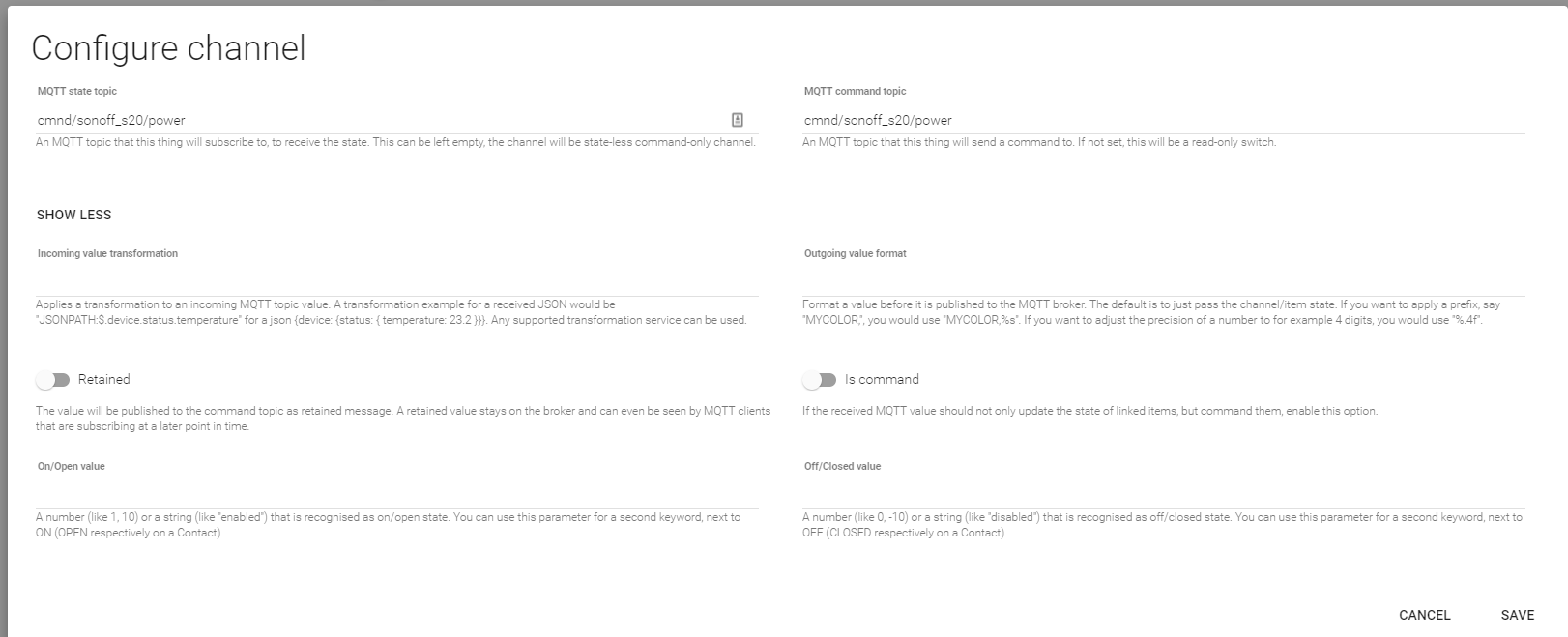

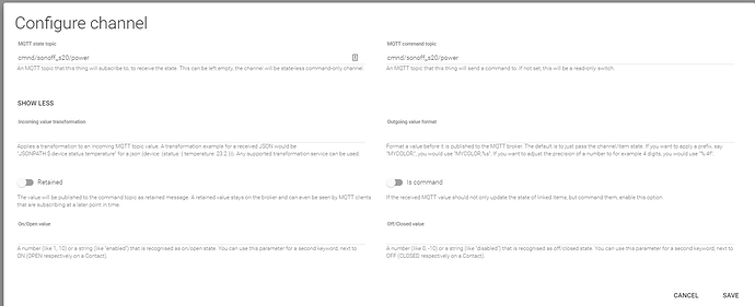

Based on my humble experience the errors you see are caused by the change of a things file, not by a faulty setup. IMHO only one definition of the broker is needed, having it in a seperate file migth overcome the error in some cases.
I’m still having this issue. The state is not represented in OH item, I can send command to that channel and it will toggle but won’t show it’s state:
