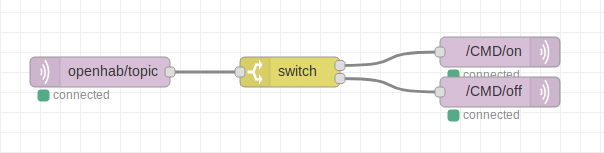

You could also have a look at node-red
Subcribe to the topic from openHAB in a node and pass it on to two outbound mqtt node each with a different topic depending on the payload
Or with a function node your can use some Javascript to separate the payload.
It would look something like this:
That’s a really good idea. I was already looking at node-red this past week for other use cases, but leveraging it to overcome this limitation seems like a good idea. I’ll have to take a deeper look. When I first thought about your diagram it seems like I’d need to have one of these for every switch I wanted to control, however, maybe that wouldn’t really be required as I could pass the required options in the message and parse that with a function. That would make adding new devices a breeze.
