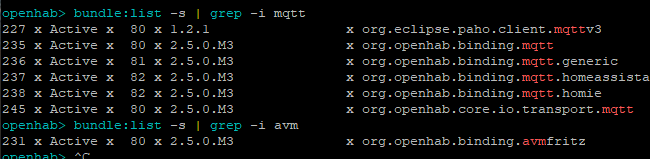

Is that a possibility for you too:
Got to the Karaf Console:
openhab-cli console
then type in:
 bundle:list -s | grep -i mqtt
and the result will look like:
This is exactly what I was looking for! Thanks a lot!
